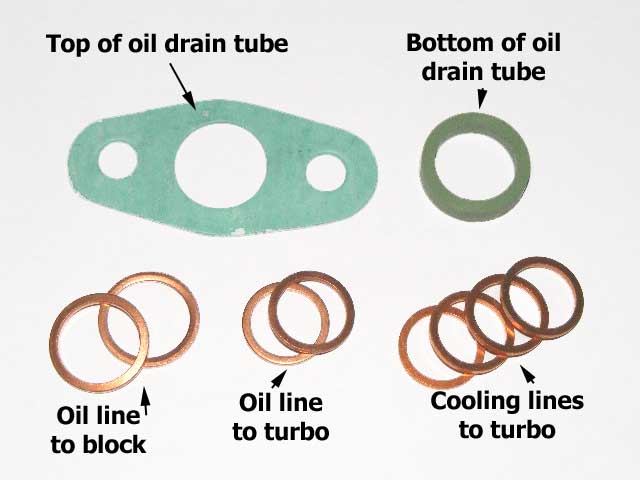

So, in my attempt to replace the rear hydraulic motor mount I rounded off the top nut to the mount Someone at Volvo should be flogged for this mount design.
1/2 of me said "screw it, dont replace it" and 1/2 of me said "do it correctly and remove the turbo." I decided to do it correctly. I still wonder which is the more sane decision.
Anywho, Im 1/2 way through the removal, with the coolant drained and the bottom bolts/nuts removed (too late to turn back). Since Im removing the turbo anyway, I decided to get iPd's HD CBV to replace what is very likely a worn spring in the stocker @ 135k miles.
What other things should I inspect/replace while doing this project?
Old Apr 5, 2013 | 02:19 PM
A new seal at each end of the turbos oil drain line would be a good thing if you're not planning on being back in there any time soon.
Attached Thumbnails Other things to do when removing turbo?-turbo-r-r-gaskets-needed.jpg
