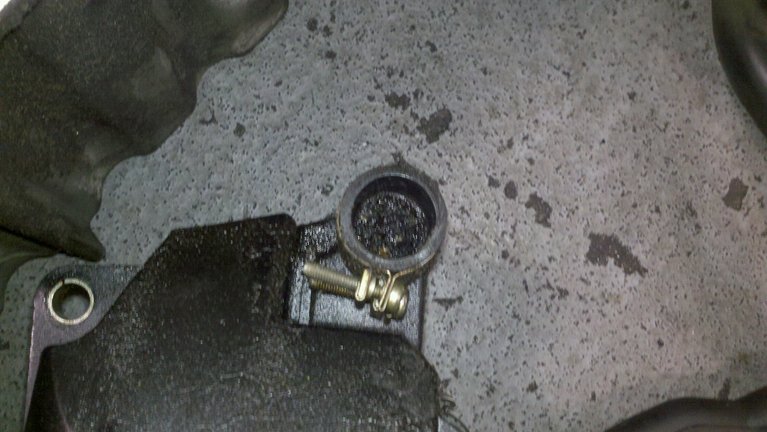

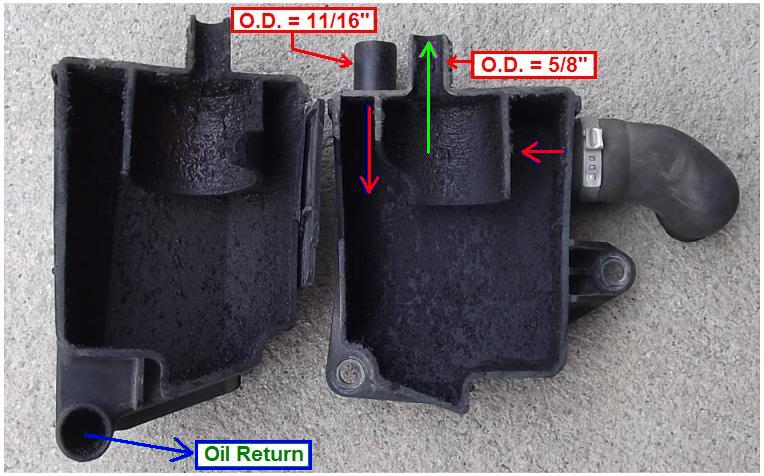

I can't think of why pulling the hose from the top of the "valve cover" would make a difference but the fact that it does would indicate you have a problem in there someplace.
Before I saw a black box cut open I always figured it was the box that plugged up from some complicated oil separation baffling. The box itself is dirt simple but the bottom can get plugged and you might be able to clean it out and just replace the rubber hoses. I did order the whole kit from IPD when I first got mine before I had done any research on it.
I'm wondering if your engine oil drain passages the black box plugs into and drains into are restricted with crud and pulling the hose let the engine suck standing oil/sludge into the intake and clear out the hoses running to the PTC valve on the plastic intake elbow that runs from the turbo to air filter housing.
If oil and crap from blow by and condensation can't drain and are building up in the box or hoses and getting drawn into the PTC it might be a reason for some smoking.
Attached Thumbnails PCV Issues?-pcv-parts-diagram.jpg   PCV Issues?-pcv-drain-holes.jpg   PCV Issues?-pcv-box-plugged-port.jpg   PCV Issues?-pcv-oil-pan-passage-blocked1.jpg   PCV Issues?-pcv-cutaway.jpg
