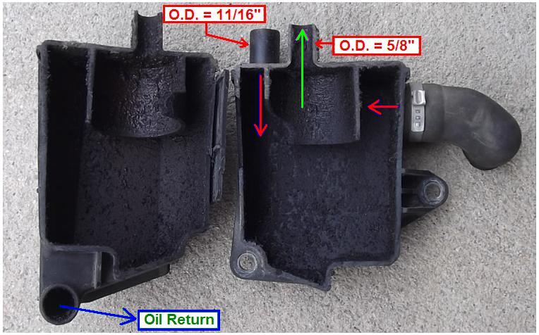

When you did the black box did you make sure the ports in the engine block were open ?? Did you try to blow through them (use rubber hose).
If those passages are blocked then replacing the box is pointless. The box itself is just a big open baffle to allow oil vapor to condense and drain back into the engine.
Did you clean out the PTC valve on the intake ??
Are you sure you didn't miss a vacuum line or that one didn't get pulled loose during re-assembly ??
Attached Thumbnails PCV job and still smoke from dipstick!??-pcv-cutaway.jpg   PCV job and still smoke from dipstick!??-pcv-passage-oil-pan-circled.jpg   PCV job and still smoke from dipstick!??-vacuum-hose-routing-ptc.jpg
