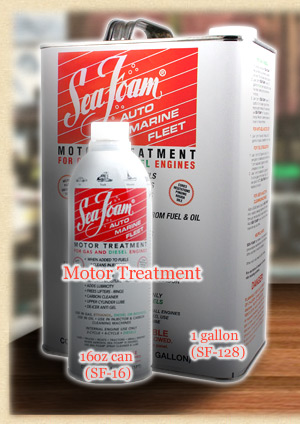

You can also try an engine cleaner like Seafoam or an engine flush chemical to help remove any of the crud you didn't get. Follow the directions.
If you have fresh oil in there, I'd toss in a can of Seafoam and give it some time to work. That and check all your vacuum hoses to make sure there isn't a leak that should be pulling those vapors into the PTC.
