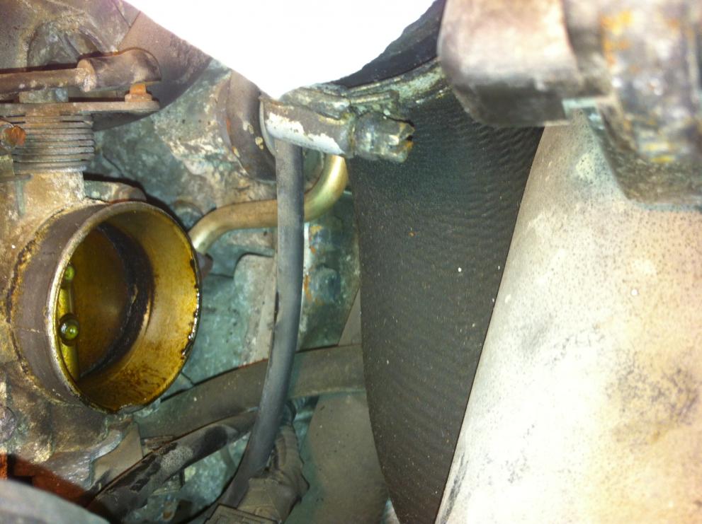

Default Phopto of pipe
Attached is a photo of the pipe, it is the gold looking pipe,middle of the photo

Yuk, I really hate northern cars.
Yes that is the EGR valve. Not sure what size the bolt is but maybe 21mm. You do have to take the time to work it off. May take about 15 minutes and it is on tight. No problem coming off and it is likly not rusted on, just tight.
