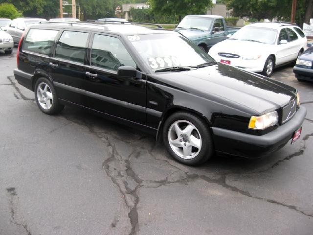

So I am working along at gathering up parts for my motor build and picked up a 19T from an "R".
I now have a "dilemma" I MIGHT be picking up a 97' T5 wagon black on black OR I will be continuing with the 94 Sedan. The issue is a downpipe. The 94 sedan has a "conical" flange 15G in it. Not sure what the 97' has since VADIS is not real descriptive and I haven't been under the hood of the car yet. (POORING RAIN here in CT today).
I need to get a look at it and see what kind of deal I can get on it.
Either way I pretty sure it is not an "ANGLE" flange housing like the 19T.
