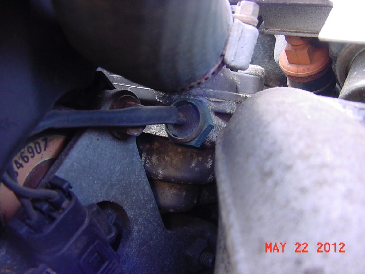

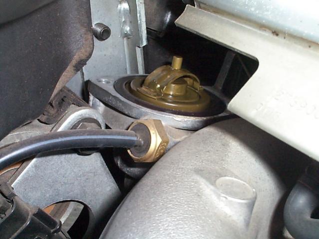

Depending on your funds it would be a great time to do a coolant temperature sensor. It's just under the thermostat and if you take a look at it's location you can see it's a nightmare to get out, at least it was for me. With the intake out of the way it's a breeze and it can prevent you from having a problem somewhere down the road.
Definitely isn't a necessary thing to do but it's a convenience to do it when it's sticking out there in the open.
