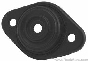

You might want to try to get a mount locally, Oreilly, Autozone, NAPA .... just to be able to compare it. Maybe they sent you the correct box but the wrong part was in it? Maybe it was the wrong box? You shouldn't have to shim them and there shouldn't be any room to do it. Using the washers to make sure you have it tight and the nut is still on "threads" and not on a shoulder at the end of the threads is a good thought. If it still rattles with the washers I'm wondering if they aren't the wrong mounts.
Since you said you snapped off some bolts I'd check to make sure the mounts are still tight against the body too.
It looks like it does fit a few models and years but still, .... it shouldn't be that loose that you can get a spacer in there.
I bought my 850 with a shock sticking through it's mount. I bought Moog mounts and they just bolted to the body and the KYB's bolted into them. Didn't have any washers, spacers or .....
The mount will fit:
VOLVO850(1993 - 1997)
VOLVOC70(1998 - 2004)
VOLVOS70(1998 - 2000)
VOLVOV70(1998 - 2000)
