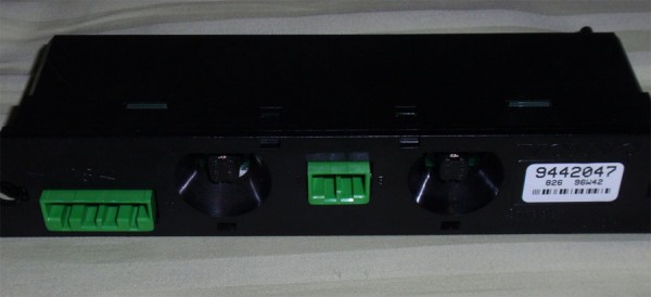

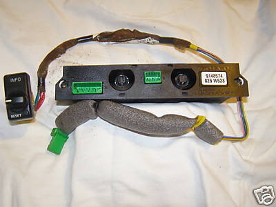

Ok, to remind you, i've got a 1995 Volvo 850 GLT 2.4L non-turbo automatic 5 cylinder w/ the Yazaki instrument cluster.
A couple years ago I tried to do this trip computer swap... I only had the clock & temp display and I looked to upgrade.
After getting my 1st one and tearing apart the dash to get in there... I realized I had the Yazaki cluster and not the VDO. So the one I got, had the gray pigtail connector on it (for the VDO) and wouldn't work. I searched and search and finally found what I thought I needed.
Part # 9148574 (confirmed with the dealer) was the one I needed. I tore in there again, popped it in with the info. switch, but ONLY the clock works. I tried another switch (the one from the VDO display that I got).... but neither worked.
Recently, while at the junkyard for something else, I found another trip computer with the same connection on the back (the large green socket instead of the gray pigtail). This one is part # 9442047. I went back into the dash and swapped it out again. And again, ONLY the clock works.
On both the 9148574 and the 9442047, when you start the car, they light up and you can see all the display options, then it goes away and i'm left with just the clock.
So...
I'm thinking either both of these are bad displays... or i've got a bad info switch... or it's not plug and play and no matter what I do I need something else to be able to send that info. to the display.
I've called a few "Volvo specialty" shops here in Denver and I get mixed responses. Some say all the 850's were "trip computer ready" and simply upgrading the display will do it... while others say it's not possible at all.
I'm stuck here... but i'd REALLY love to get the display working.
Thoughts?
Thanks for the help.
