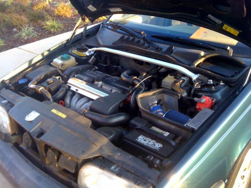

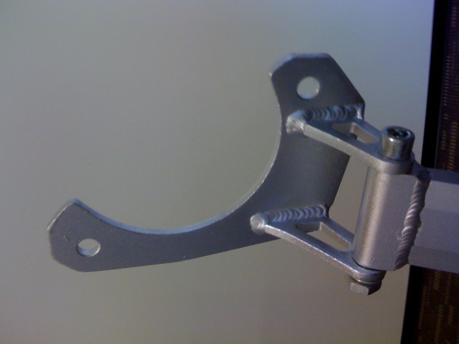

I am still at work so I will install it tonight. Here it is...

Looks pretty solid as well as a perfect place to mount a catch can when that time comes.

Those welds don't look that bad.... I will have to look into one of these. Keep this thread up to date. I'm curious what you still think in 45-60 days!

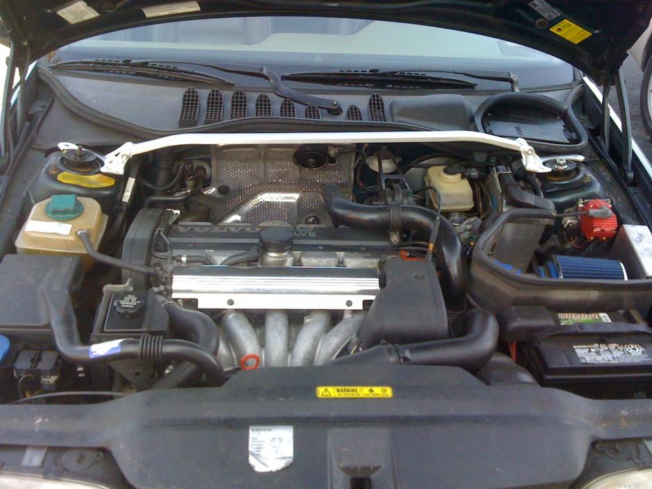

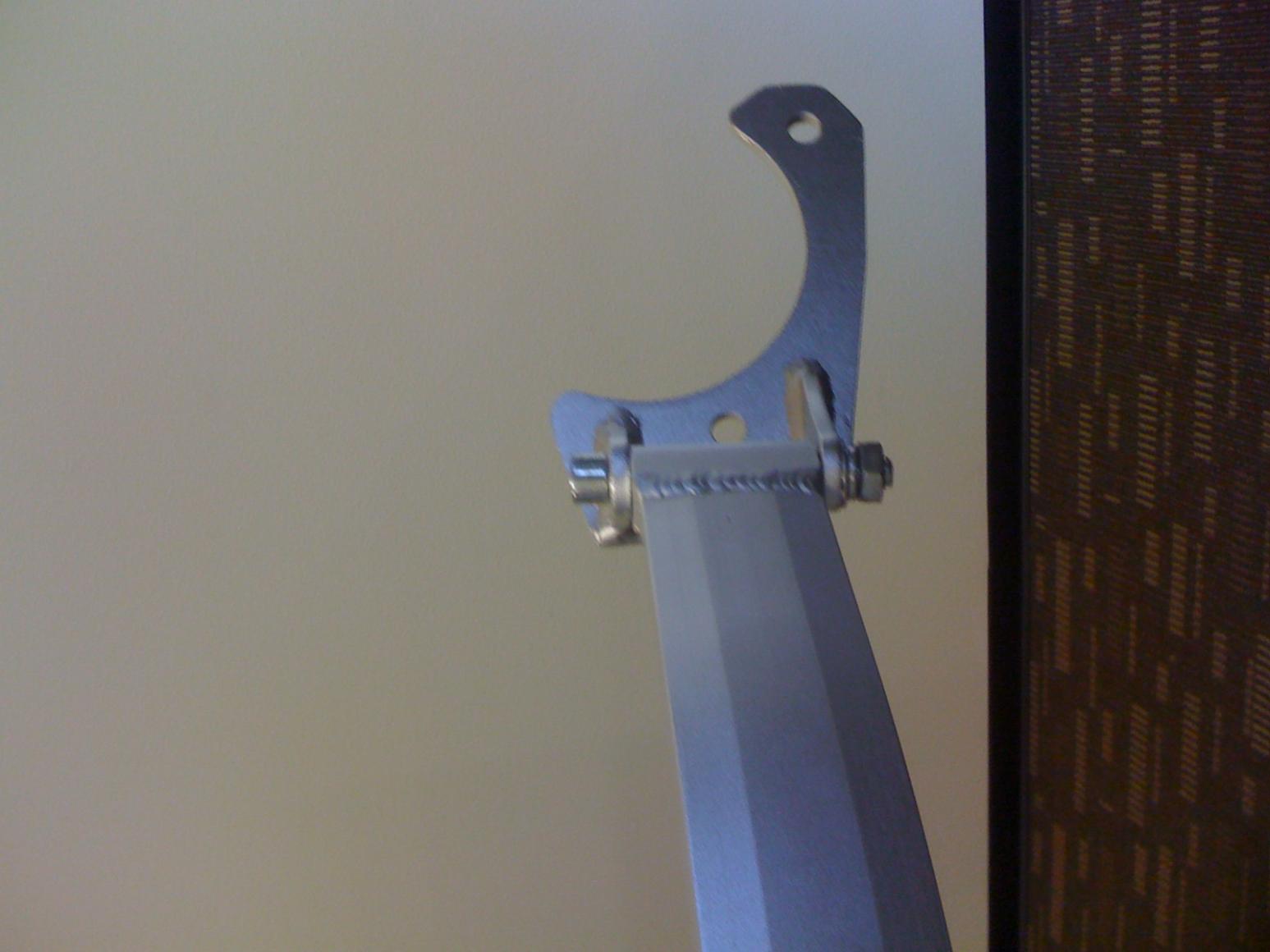

It installed pretty easily, a couple minutes. Fit well. I dont have pictures cuz it got dark.

Nice! That will be a definite addition to my wagon.

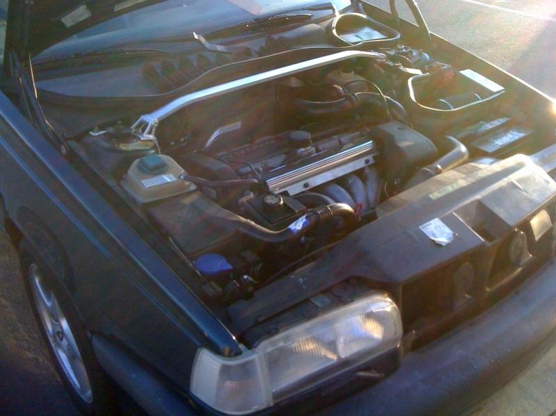

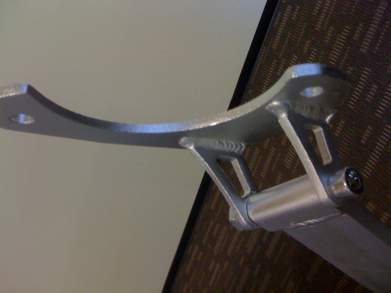

More Pictures

Looks awesome. Have you given it a test drive yet? Any difference?
