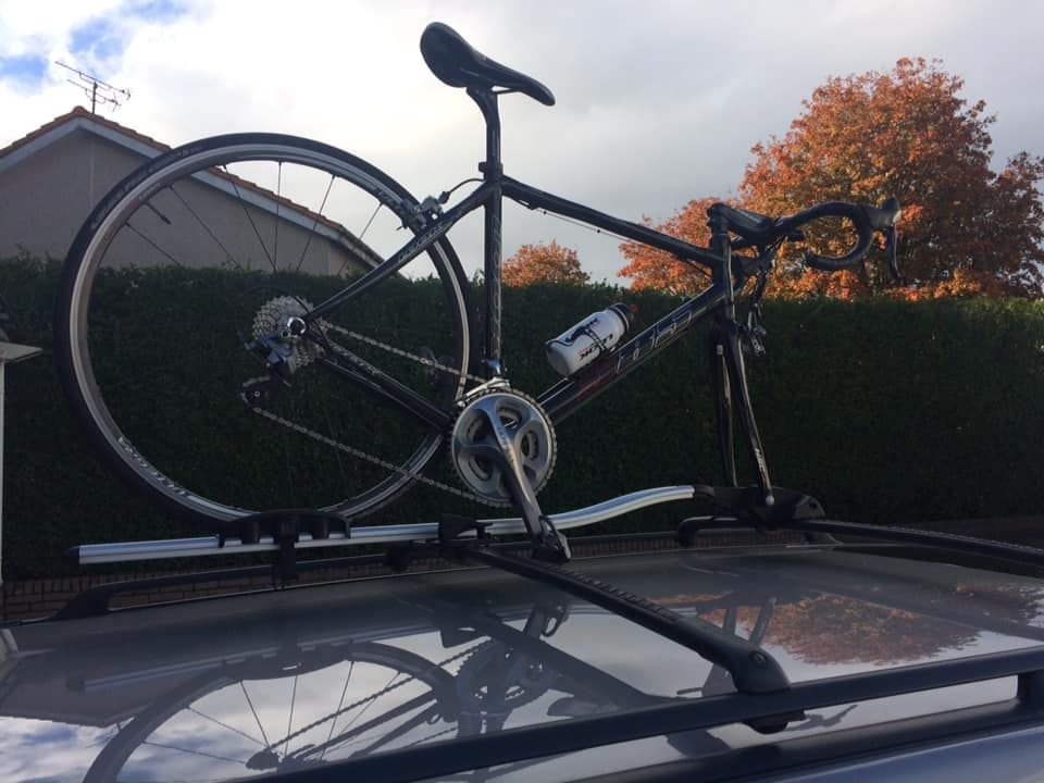

I had the same problem, I bought a 3mm thick silicone rubber sheet and cut some new pads to shape. I left the original rubber pads in situ and placed the new cut pads between them and the roof rails top and bottom. It's solid now and doesn't move Link to silicon sheet on eBay
