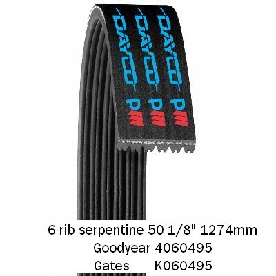

Thanks to this thread I also solved the same issue of bypassing the AC compressor by using a shorter serpentine belt. I also used the same belt from NAPA, a 6 PK, 50 1/8" (1274mm). For reference, when I measured the distance using the old belt threaded around the pulleys, I came up with 49" (1245mm). Though I imagine using this exact length might be difficult to actually pull over the lip on the pulleys easily. So I went with the length tk1769 used which worked perfectly for me as well.

Old Nov 23, 2011 | 10:37 AM
Gates and Goodyear PN's, can interchange easily to any parts store number.
Attached Thumbnails Serpentine belt 1997 850 GLT-heat-n-ac-ac-bypass-belt-k060495.jpg
