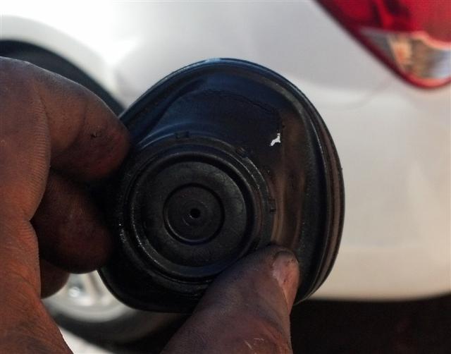

Since I had no vacuum on the blow off (bypass valve) I pulled it and installed the used one I picked up from the jy. My old one did have a hole in it so, I'm guessing that has been my issue.
Now that I have that out of the way, it seems that I am under boosting. Not sure if I have a bad vacuum line going to my boost gauge or not but it seems to be showing me getting about 6 psi of boost. I guess there is a chance that my waste gate is out of adjustment. I'm going to use my ScanGauge to check my HP output. If it is lower than 210 hp I'm going to adjust or replace my waste gate.
