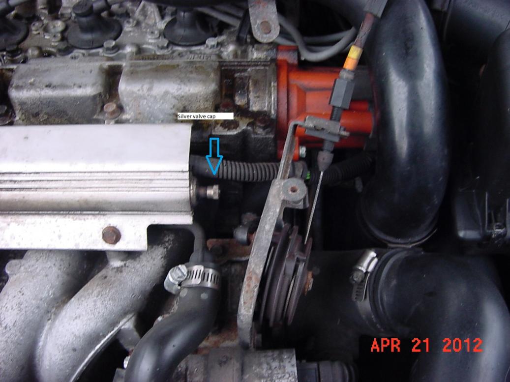

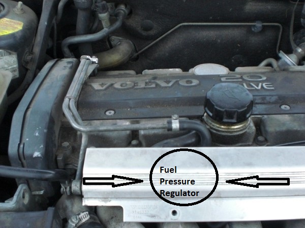

If it's a 94 the fuel pressure regulator is under the aluminum cover of the injectors right on the front of the engine. At the driver's end of the cover is the connector you need when you connect a fuel pressure gauge.
Where are you located ??
When it doesn't start, does it crank and just not fire or doesn't it crank ?? If you let it sit and cool down will it start up ??
If it cranks and doesn't start you should try to pull the coil wire off the distributor and check for spark. Narrowing down lack of spark or fuel will help a lot.
