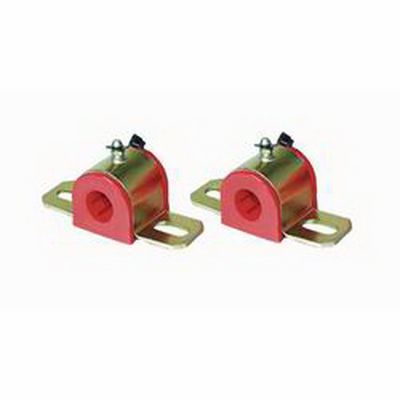

If you have a 20 mm or 13/16" sway bar the part number is:
Energy suspension 9.5124R or greasable 9.5157R
Looks like AutoZone has the best price.
Attached Thumbnails  sway bar bushing removal-sway-bar-bushing-energy-9.5124r.jpg    sway bar bushing removal-sway-bar-bushing-energy-greasable-9.5157r.jpg
