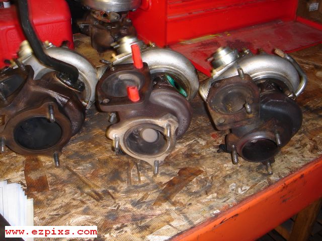

I may have missed it but what year is your 850 ??
If it's a 94 or 95 with a stock 15 turbo the housing is the dreaded conical and very restrictive.
If it's a straight flange then yes you can just mount your old exhaust housing on the 16 and away you go.
Getting a bigger downpipe at some point would help you get more out of the bigger turbo.
Would also be helpful if you entered your location in your profile. That way someone who has what you need might see they are close enough to send it to you.
In the first picture the conical is the one on the left. The flange is actually like part of a ball and the pipe is flared at the end like a "bell" to fit over it. The straight flange is just flat and bolts "face" to "face" with a flange on the end of it's downpipe. As you can see the straight flange is a larger ID and will pass more air easier and with less restriction.
Second picture the angled one is on the left, straight in the middle and conical on the right. You can see a big difference between the angled outlets inside diameter and the conicals.
Attached Thumbnails T5 2.3 New turbo, where to buy new downpipe? And other questions about fuel jets etc.-turbo-conical-vs-straight-flange.jpg   T5 2.3 New turbo, where to buy new downpipe? And other questions about fuel jets etc.-turbo-outlet-flanges.jpg

My t5 is 1995 model
i live in finland
I ended up buying Ferritta 3 inch downpipe including race cat, because i got it cheap.
Only problem is, that its with straight flange...
What kind of modifications i have to do to downpipe to get it fit with angled system? Is it hard? Do i need some separate 3 inc pipe for that work?
Other opinion is, that i take the straight flange from my old 15g turbo.
If im using my old exhaust side from the 15g turbo to get the straight flange, am i losing power for that?

The easiest would be to use the straight exhaust housing and mount your pipe.
I don't know at what point the bigger angled flange outlet would be better than the straight but for a 16 I would think it wouldn't make much of a difference.
