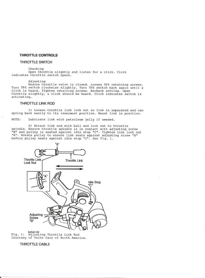

Visually inspect the throttle cable & linkage. Clean & lube if you must.
JPN
Attached Thumbnails Throttle sticks open!!!-850-throttle-adj-2-.jpg   Throttle sticks open!!!-850-throttle-adj-1-.jpg

+1, I forgot to mention that the cable could be getting stuck on the spoil and causing the cable to rid in the rig wrong. This would keep the throttle from closing all the way.

Another tip as well. Also see if the mount at the firewall is broke. If it is they can hang the throttle open.
