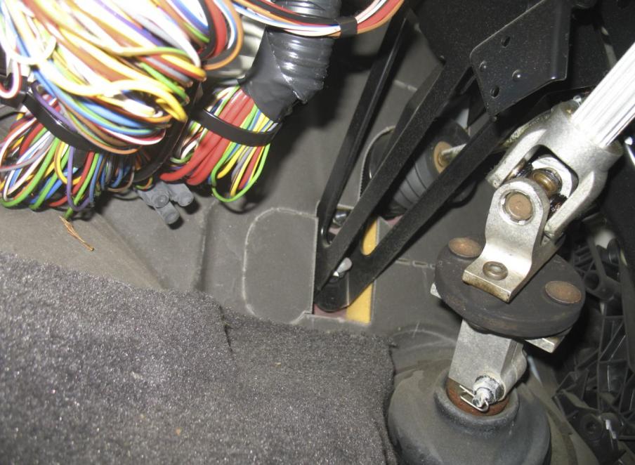

So I picked up an instrument panel from a '96 which has the turbo gauge and I want to hook it up, but I have no idea where the hose is supposed to run. I wasn't expecting a flashing neon sign, but I’m lost! Anyone have pictures I can reference? I know where it starts and where it ends, it’s just the middle part I can’t figure out!

Found it! Little bugger was hiding on me:
See it? That three-pronged thingy just behind the wires. In the engine bay, it pops out down low between the master cylinder and the strut tower.
