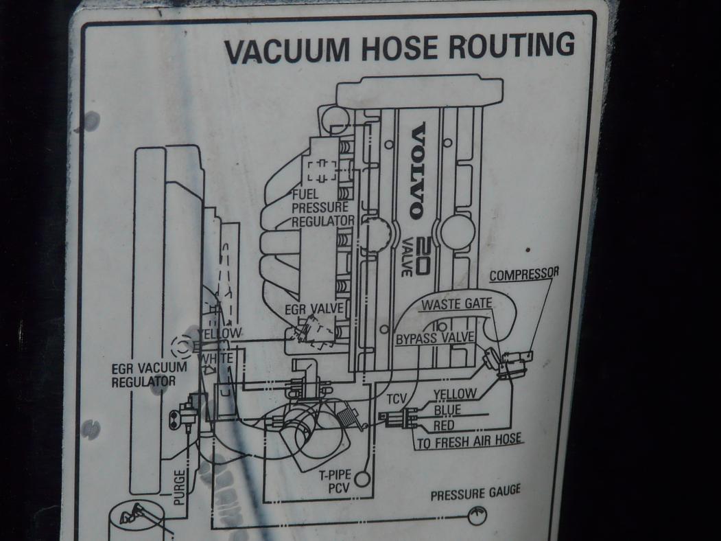

Vacuum diagram should be printed on top of the throttle cable cover. gilber is correct - the wastegate isn't opening up. You either had the hose come disconnected at the turbo or possibly your tcv is bad.
Old Jul 9, 2010 | 10:55 AM
boxpin's Avatar
Joined: May 2009
Posts: 2,702
From: Rocklin, Ca
Vacuum diagram is on my hood...fyi. I vote wastegate or vacuum to.

thatks for posting that, boxpin....its a LOT clearer than mine is.

So I have a question, because mine has been doing the same thing since I replaced my knock sensors/PCV system. The vacuum line going to the TCV, do they need to be connected in a certain order? Or can you hook them up any way? I didnt really pay attention to which line went to which spot of the 3 wires that connect to the TCV.

Uh, yeah, it matters.

Absolutely it matters. that valve is electronically controlled and directs air through each line individually when it should if they're in the wrong place, it's going to cause either excess boost or NO boost.
