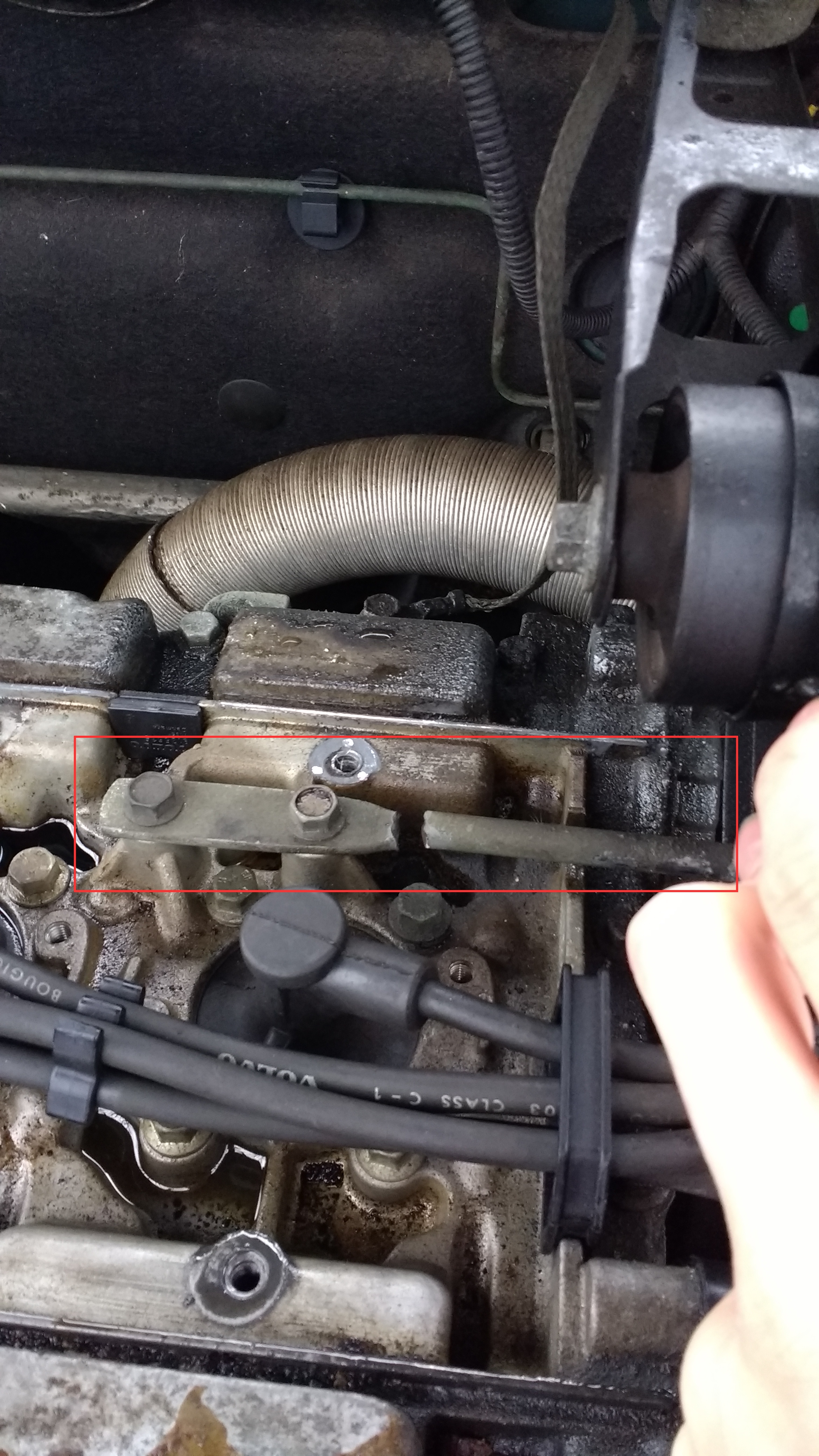

Hey all, the pictured part broke pretty violently on the highway, causing the whole torque arm to rattle around and the engine to shake in the bay. The two larger (13mm?) bolts holding the arm to the block were also loose. What is it called and where can I get a replacement? Luckily I was able to pull one off of my spare 850 but I'd like to buy a backup. For reference; it's a 1994 850 NA 5-spd, and the one on my 1995 NA auto was the same part.

Credit to bmdubya1198 at MVS for the answer:
This seems to be the part you're looking for, #26 in the diagram:
It is part number 9434264, called "Stay." Check out FCP Euro or the dealer. I got the diagram from Volvo Parts Lisle, and they have the part available as well.
Parts numbered 26 and 28 pictured were 14 dollars shipped from Volvo Parts Lisle.
