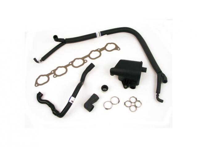

The black box itself isn't anything special. It's just a slightly baffled box to separate oil from the vapor going into the intake to be burned. Unless the ports of the box are plugged you likely only need to replace the hoses. The hoses can and do break down internally more often than externally so looking usually won't tell you their condition or if they are plugged internally.
You also want to make sure to carefully remove and clean the PTC valve in the intake tube just before the turbo.
http://www.matthewsvolvosite.com/for...c.php?p=226269
