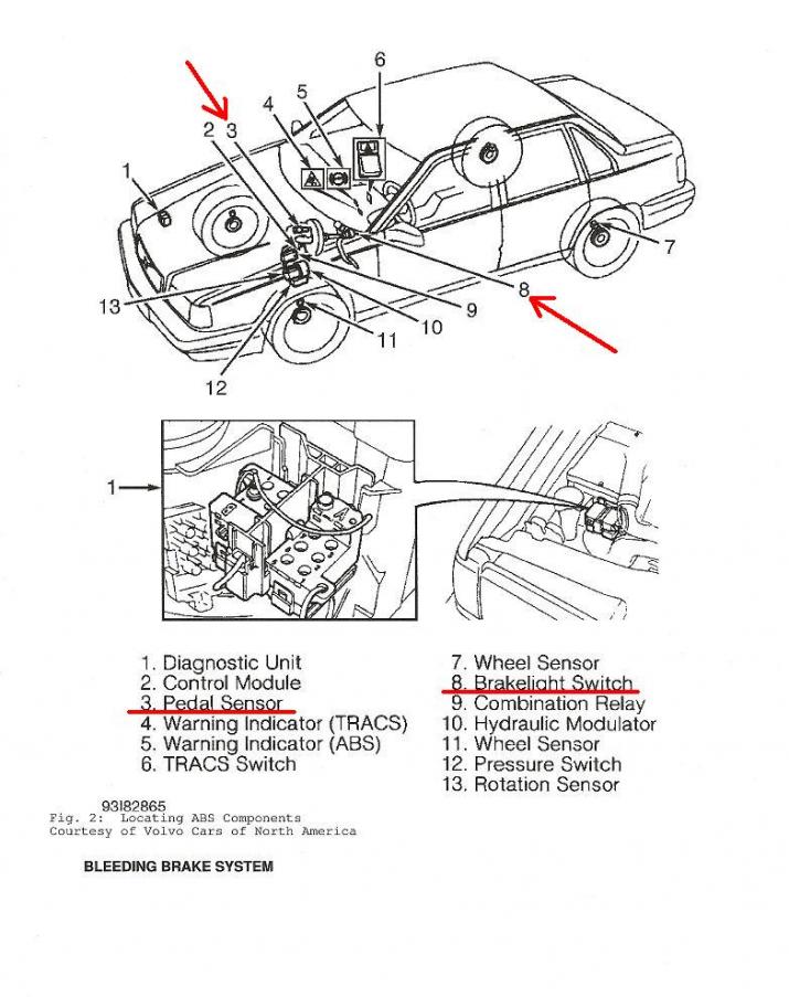

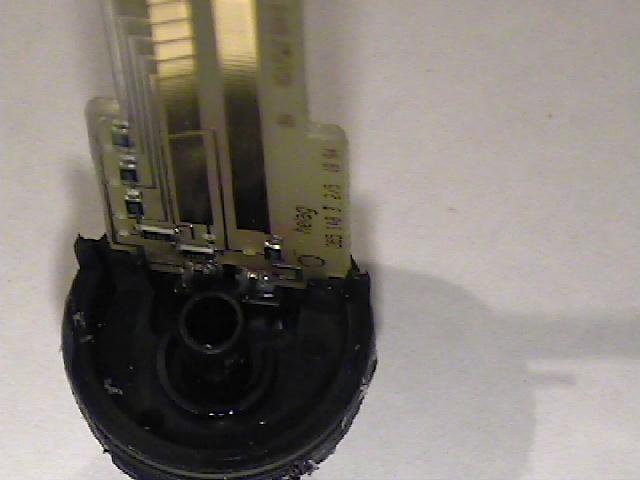

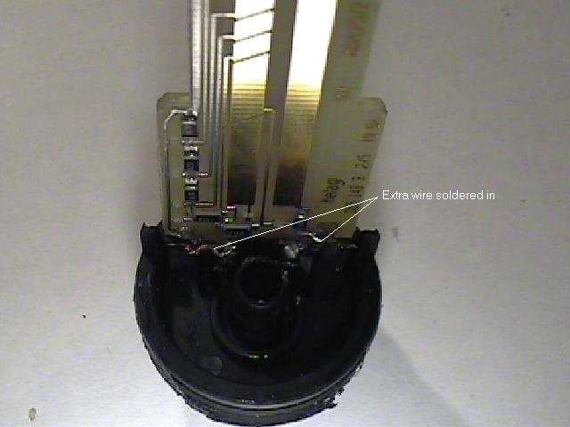

The ABS is known to fail on 850s but can usually be dealt with. Since your 850 is 93 model, I believe you need to repair the brake light switch and the pedal sensor.
There is a great write-up by a gentleman named Arzy. See if you can find it. If you can't find it, I'll post a couple of pics.

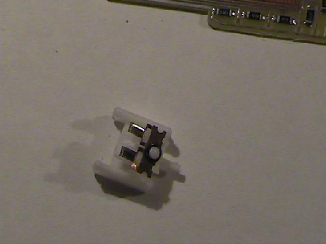

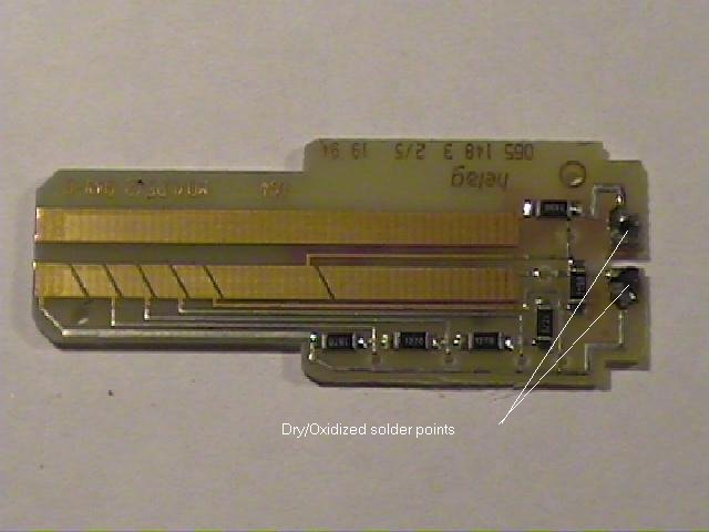

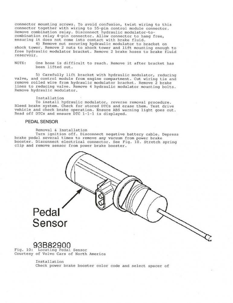

Your 850 is 93 model, so it may not be the module that is faulty, and most places don't deal with anything prior to 96. If you can't find the post by Arzy (successfully repaired the pedal sensor and his ABS came back to life).
I'll attach the pics.
JPN

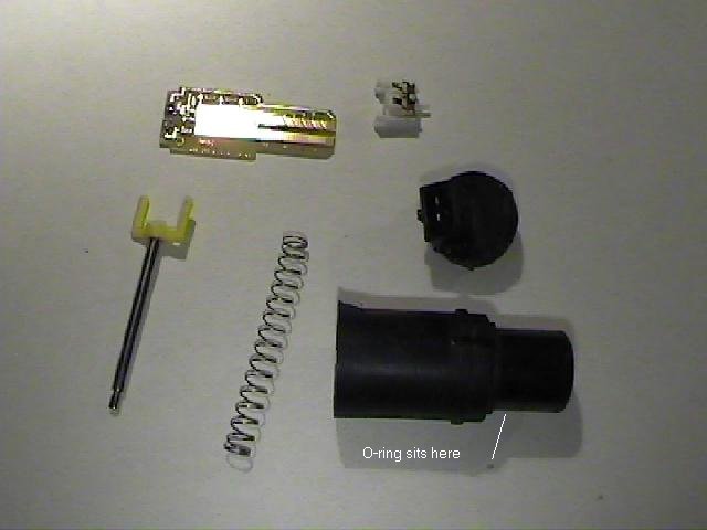

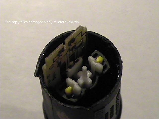

2nd wave.
The pics are a courtesy of OZBrick, Australia.

Had the same ABS issue with my 94 850, I brought a used pedal position sensor for 10 bucks. Took about 5 minutes to swap them out and have not had an ABS light since.
