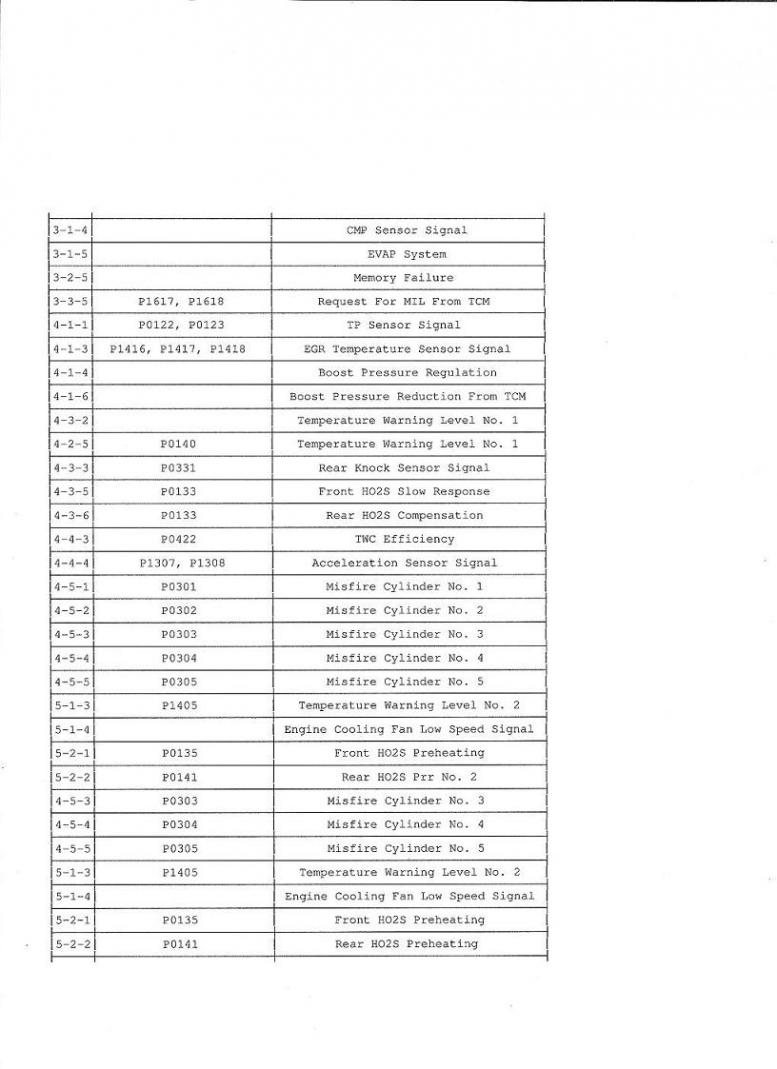

Fyr-1
jpn
Attached Thumbnails Volvo 850 stalling problem-850-turbo-detailed-obd-i-1-.jpg   Volvo 850 stalling problem-850-turbo-detailed-obd-i-2-.jpg   Volvo 850 stalling problem-850-turbo-detailed-obd-i-3-.jpg   Volvo 850 stalling problem-850-turbo-detailed-obd-i-4-.jpg   Volvo 850 stalling problem-850-turbo-detailed-obd-i-5-.jpg

FYR-2
JPN
NOTE: These are from 94-96 turbo and yours may slightly vary in set-up.
Attached Thumbnails Volvo 850 stalling problem-850-turbo-detailed-obd-i-6-.jpg   Volvo 850 stalling problem-850-turbo-detailed-obd-i-7-.jpg   Volvo 850 stalling problem-850-turbo-drivability-problem-3-.jpg   Volvo 850 stalling problem-850-turbo-ceu.jpg
