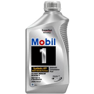

Did you remove the drain plug and then add the same amount back in or did you pull the cooler line off and do a flush that way ??
Have you checked the level the "Volvo" way ??
CHECKING FLUID LEVEL
1) Ensure vehicle is level. Apply parking brake and gear
selector lever to "P" position. Start and idle engine. Move gear
selector lever through all gears, while pausing 4-5 seconds for
engagement at each position.
2) Return gear selector lever to "P" position. Wait 2 minutes
and check fluid level with engine idling. Level should be between MIN
and MAX marks.
Attached Thumbnails Volvo 850 transmission issues... HELP PLEASE!-transmission-fluid-dex-merc-mobil-1.jpg
