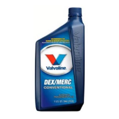

Draining it and trying again is the best and least expensive thing to do at this point. Just to be sure, I'd try and use only one brand and one type, DEX/MERC would be good.
Not sure on Volvo's specifically, but on most vehicles some of the transmission codes will come up on an OBDII reader.
Attached Thumbnails Volvo 850 transmission issues... HELP PLEASE!-transmission-fluid-dex-mec-valvo.jpg
