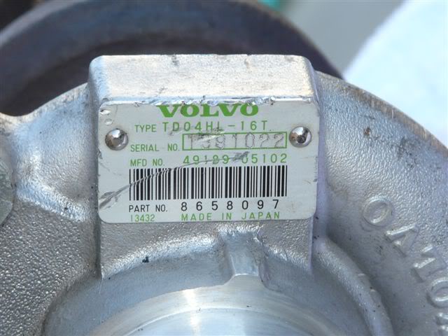

I have a Volvo 850 turbo 1996 model. Where is the ID plate located (on the turbo) that has the specification of the turbo?
The turbo is original so I am thinking it is TDO4HL 13T/13G?
R

Big block on the compressor housing

The turbo is not easily accessible. So based on the picture, I am thinking it is below the point where the inlet hose connects the turbo?
