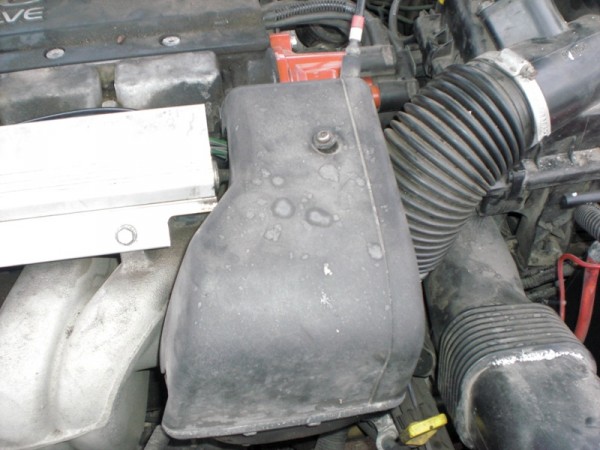

Old Apr 21, 2012 | 04:50 PM
For those who don't know.
The valve is at the drivers end of the fuel rail. It's easier to get to if you remove the cover for the throttle linkage.
Attached Thumbnails Where to check fuel pressure and how much-fuel-injection-schrader-valve.jpg   Where to check fuel pressure and how much-dsc01210.jpg
