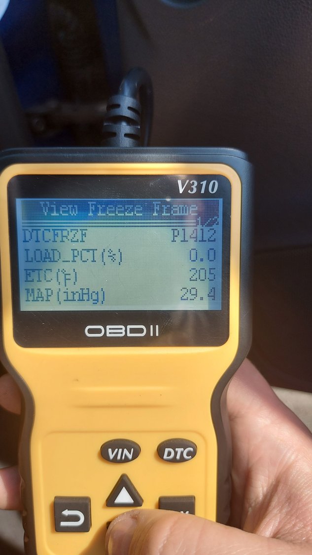

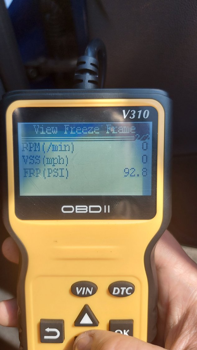

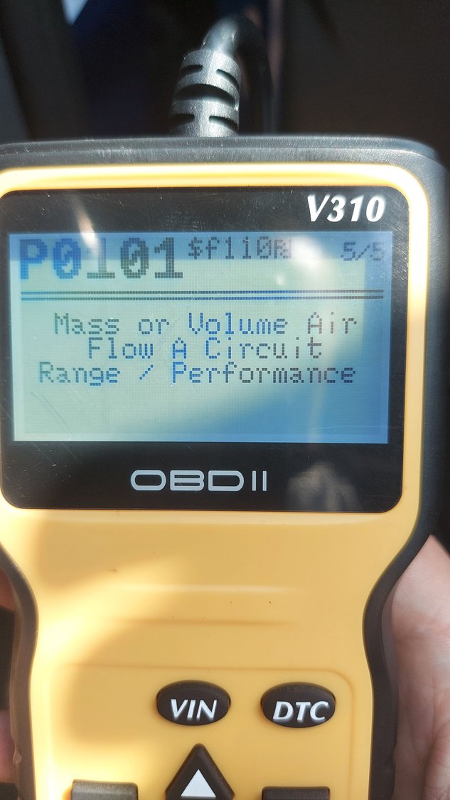

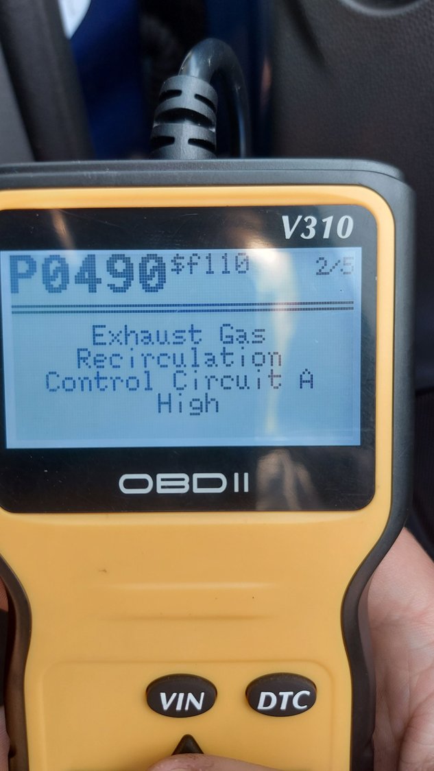

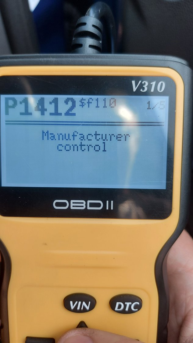

so after that i left it for a day went back and now it wont start..sounds horrible when its trying to clunky..and it only manages to stay started for a few seconds when my foot is fully pressed on accelerator..then dies..im pulling my hair out..batterys starting to die have to keep putting mrs car to it to get some life...i have these fault codes.. im litrally gonna scrap or sell for parts if i cant fix it..just dont understand how it starts one day and runs ok then next it sounds like a clunky tractor and wont start

Given you own a diesel, you may be better off posting on the UK forum - at any rate, here's an interesting thread on the P1412.
https://www.volvoforums.org.uk/showthread.php?p=2381330
The P0101 points to the MAF signal to the ECU. Start by inspecting hoses/ check for air leaks, consider cleaning the MAF (use MAF cleaner not carb cleaner).
P0101 Common Problems
* Large vacuum leaks, split Intake Air Boot or PCV Hose, defective intake manifold gaskets
* Mass Airflow Sensor (MAF)
* Mass Air Flow Sensor circuit and or wiring problems
* Defective Barometric Pressure Sensor
* Dirty or contaminated Mass Air Flow Sensing wire or filament
* PCM software needs to be updated
