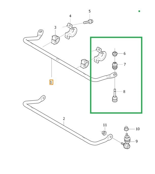

There are 2 styles of rear sway bars and links. The upper style links on bar #1 - don't last very long. If you have the upper style and don't like having to keep fixing it - you will have to change to the #2 lower style bar and links.

My mechanic says style 2 is what I’ve got.
Any other suggestions? We’re installing Volvo brand today and they said the do look more “stout” so perhaps that’s the answer.

Aftermarket parts obviously don’t do well on this car and after no fewer than 5 (likely more, I’ve lost count) sway bar link end replacements, the Volvo brand is NOT coming lose or rattling. My mechanic says it’s a lot beefier than the Dynas and comes with dual washers to hold it in place more securely. The hole it was going through was getting damaged too.
