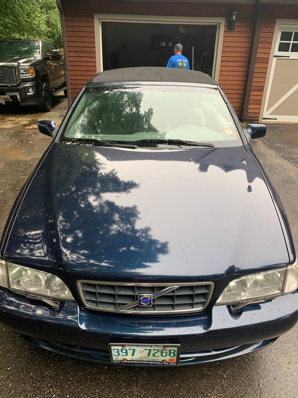

hey everyone,
I just bought a 04 C70 convertible and I love it. I was just wondering since I bought it off someone who did not use it very often or take meticulous care of it, are there any recommended maintenance I should do with it to maintain it running smoothly. It seems like quite a finicky car and want to start to learn what’s important on it. Also if you have any reccomended modifications please let me know.

How about mileage and service history - that top is going to need to be replaced - rear window is coming loose -

140k mileage and not too sure about service history. No lights on and sounds good. Was hoping I could just get it filled with a sort of seal by the rear window. It’s honestly tightly on just convertible weather seal ripping.
