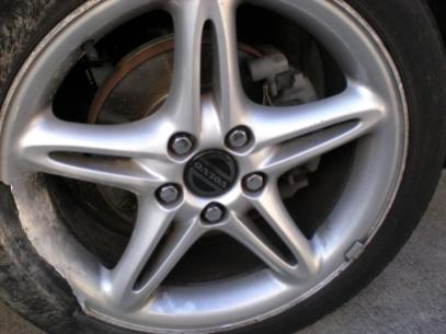

Old May 27, 2009 | 12:42 AM
brgbldr's Avatar
Joined: May 2009
Default C70 wheels
Originally Posted by elav
What type of wheels do you have. I have a set from my 2000 C70 Coupe and I'm in N. Cal.
My wheels are the double spokes. I've attached a picture.
Old May 27, 2009 | 12:47 AM
brgbldr's Avatar
Joined: May 2009
My biggest problem now is to determine ahead of time if I'm getting into too deep of water or not. I definitely know that the subframe is bent. It is basically crushed in about one inch at the points where the lower control arm connects to it. (Especially at the rear connection & lesser so at the front). I want to make sure that it is fairly easily repairable before I tear into it as I have the option at this time of submitting it to the insurance company, but I won't have that option after I tear into it.
It appears to me that all I have to do is replace the subframe, (found for $500 used), and the control arm on the right side and one or two rims and a little body work where the curb hit under the rocker panel. My cost should be around $1k, but I don't have a clue how difficult of a task this is. Also, should I expect a lot more damage? Aside from the bodywork, is this a weekend chore or a multi-weekend task, or worse?
