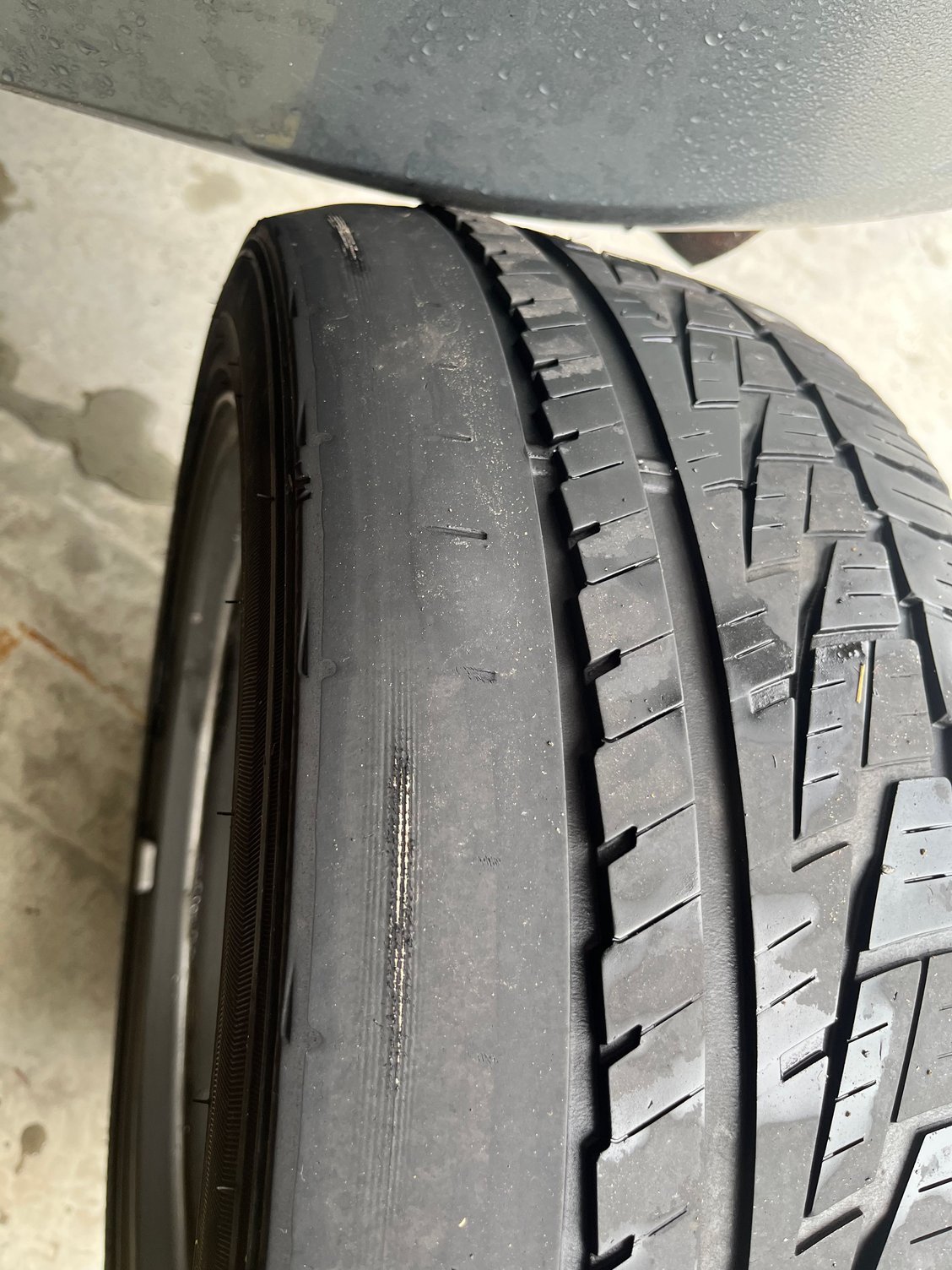

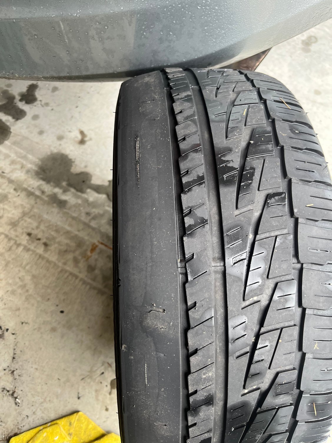

Here’s what the rear tires look like. My plan is to install new lower control arms and new adjustable upper control arms. I have 160,000
miles and original components. Anything else I should look at in order to fix this problem or should the upper and lower control arms do the trick?
Thank you
