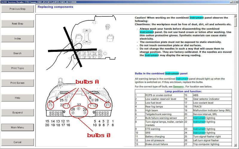

Ok, I was looking thru Vadis and found this but it doesnt really the bulb numbers, I think the 194 bulbs are the top 4 for the gauges. But what would the bulbs B be, of course this is for the LED swap.
