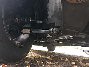

I just did mine a couple of months ago on my '99 V70 (together with the drive shaft), I had the stand under the car and used the jack to raise the hub assembly so the control arm was leveled. It's almost impossible to align or tighten the bolts otherwise. Just like with anything, after you are done and driven the car for a while make sure to check the bolts again. That's all, you should have no problems otherwise.
Good luck!

Correct Xerxes, it's just to compress the spring/shock to align the holes, otherwise you can't even get the bolts in place. Jack up the hub till the holes are aligned, slide the bolts in there, tighten them and you're ready to go. Again, double check after driving for a while.
Good luck!
Blade~
