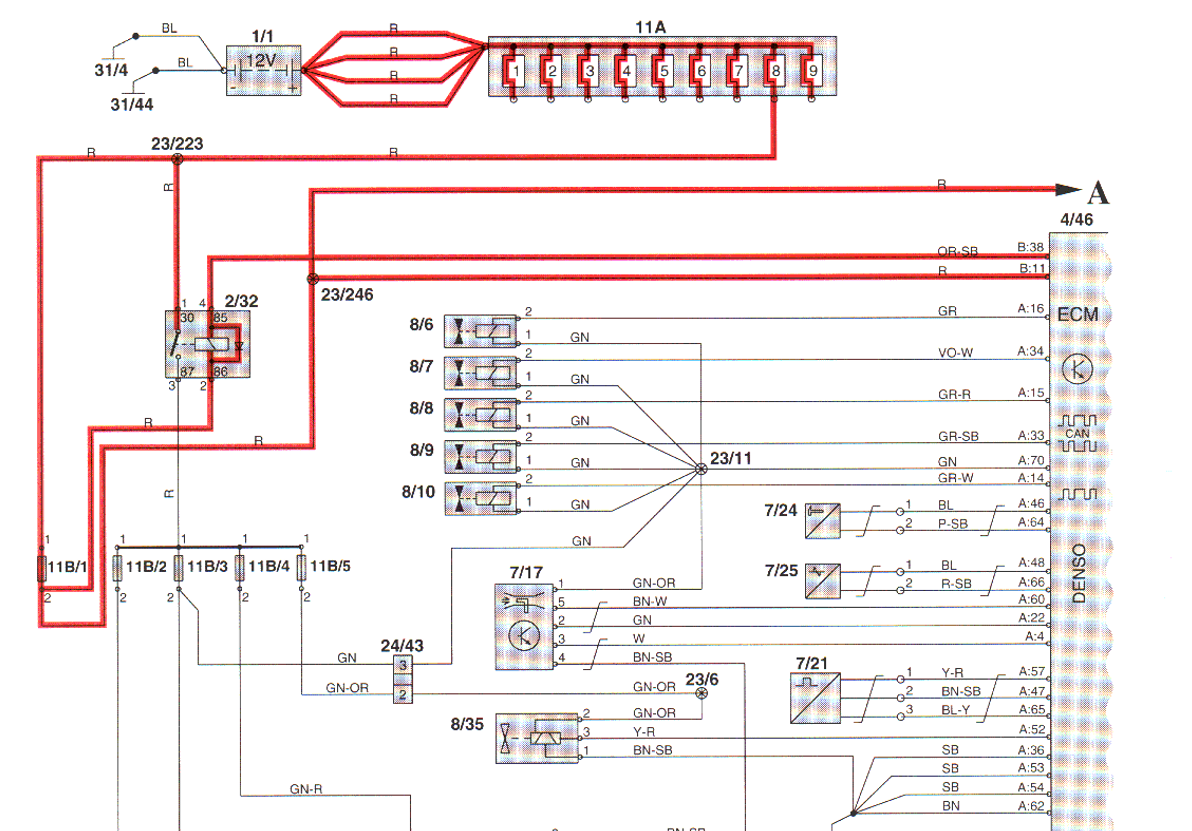

New spark plugs. Coil packs are original but they shouldn't all stop sparking at the same time after head gasket replacement, right? I tested main relay and there's 12V at pin 30. I get continuity between 85 & 86 (19 Ohms).

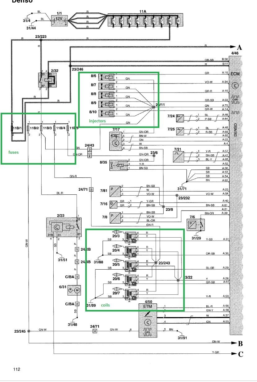

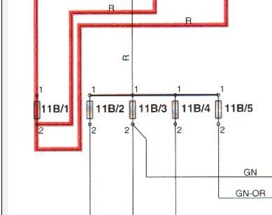

Stupid question. WHat is 11a 1-0 below? Are those fuses? I don't see fuse 11 branching out. I see fuse 11 is just one 15A fuse. By the way, I tested all the fuses and they are good. I assume 11B 1-5 are coil pack pin 4.Is that correct?
Resistance between pin 1-4 on coil packs harness connectors and Main Relay 87 is open.

The screenshot is showing fuses 1-5 in the B fusebox. Instruction how to use Volvo wiring diagrams can be found in the first few pages of each book. And diagram books can be found
https://volvodiag.com/ewd-online-eng/
Oops, sorry car is too old - instructions on what the symbols mean in any of those books should help -

Here's a diagram for most of your fuel system and sorry - did not answer your 11a question - page from the book below should explain it

I get no resistance between pin 87 of main relay 2/32 and pin 4 (or Pin 1, 2 or pin 3) of any of the coil packet harness pins. What should I get at any of these pins?
