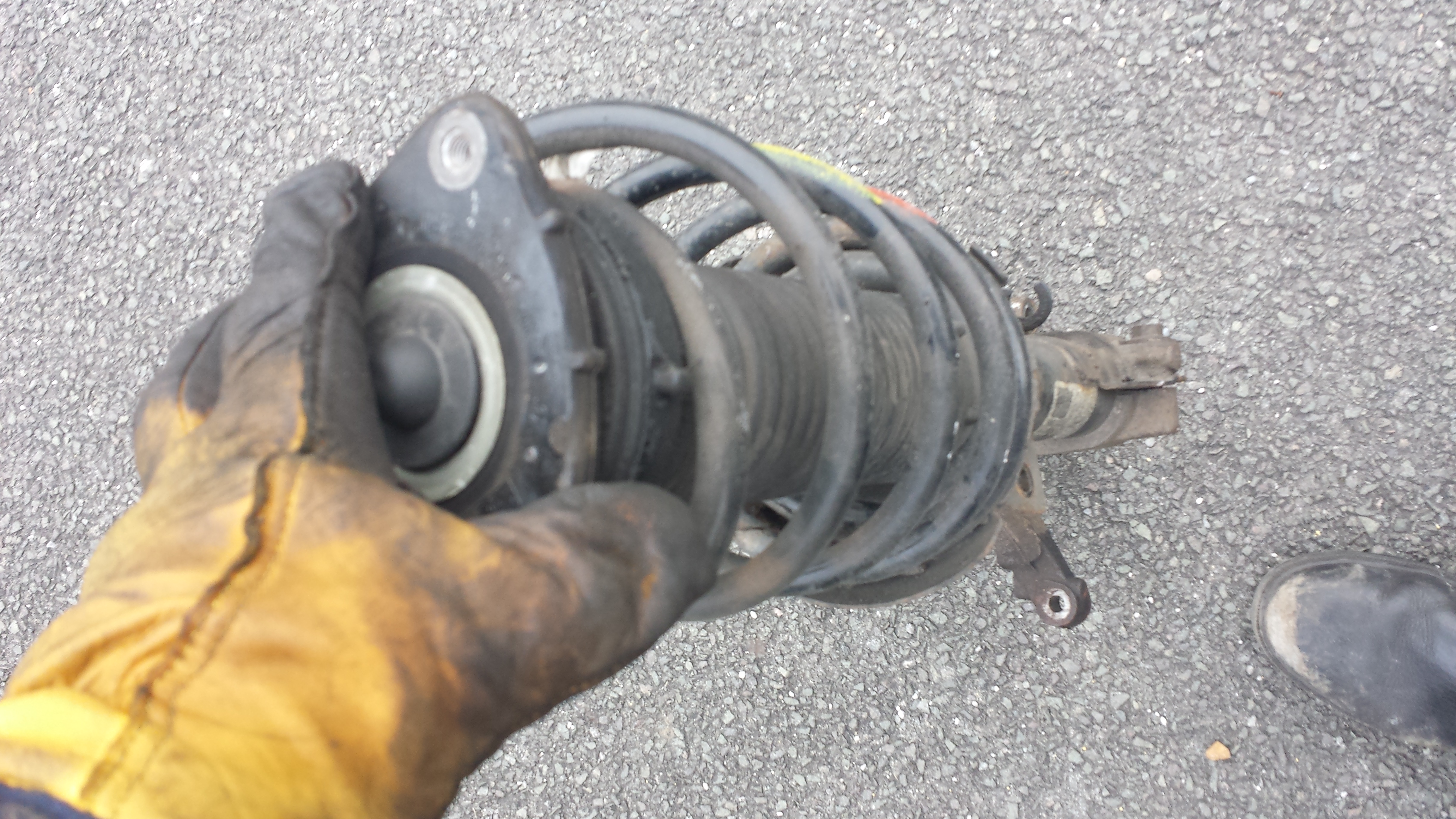

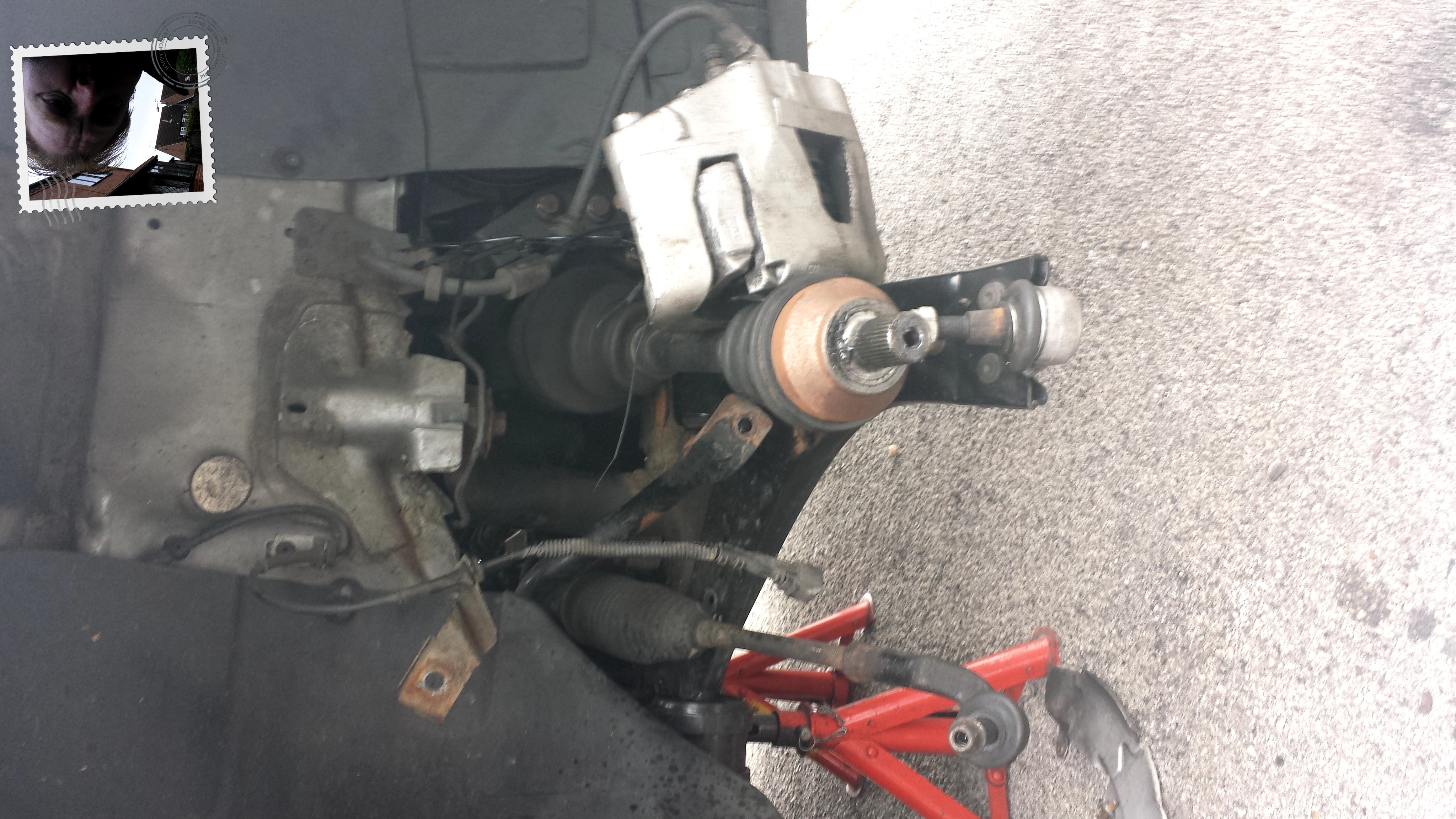

once you remove the strut brace bolts then the bar then un do the 3 strut bolts leave one in place to hold.
take off the anti roll bar link and throw away.
Un-do the bottom arm bolt leaving it on by a couple of threads then using pry bar and wack the knuckle, then they come apart no need for a knuckle splitter. leaving the bolt one stops you damaging the thread.
remove the caliper and mount and tie out of the way, no need to remove.
take off the disc and un hook the abs cable.
un do the hub nut I did this then slid out the driveshaft.
remove the bolt still holding the top strut and slide out the complete unit quite heavy.
undo the bolt on the leg holding it to the knuckle mine just slid off but you can use a chisel to separate the clamp a bit.
I did this by trail and had nothing to lose saved myself a lot of cash.
cheers ian
