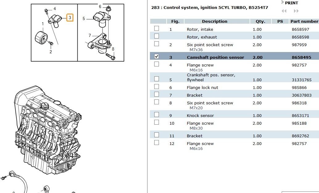

Hello,we think we've narrowed the issue down to a failure in the cam sensor but we've scoured the internet and asked volvo mechanics and dealers on where the sensor exactly is but we can't find it. I've taken some pictures in the approx area, if someone could help highlight it, that'd be wonderful, thank you.

They (there's 2) are mounted on the ends of the cams. And it's probably not a cam sensor. They don't fail very often. What codes do you have and why do you think a cam sensor is bad? I think you are just guessing, and that gets expensive and frustrating.

To answer your question the cam position sensor is mounted on the end of the cam/s. But usually it's not a bad sensor - it's the cam timing is very slightly off - if you don't get the VVT/cam timing adjusted perfectly you will get a cam position sensor code. Not meaning the sensor is bad - it means the cam is in the wrong place at the wrong time.
