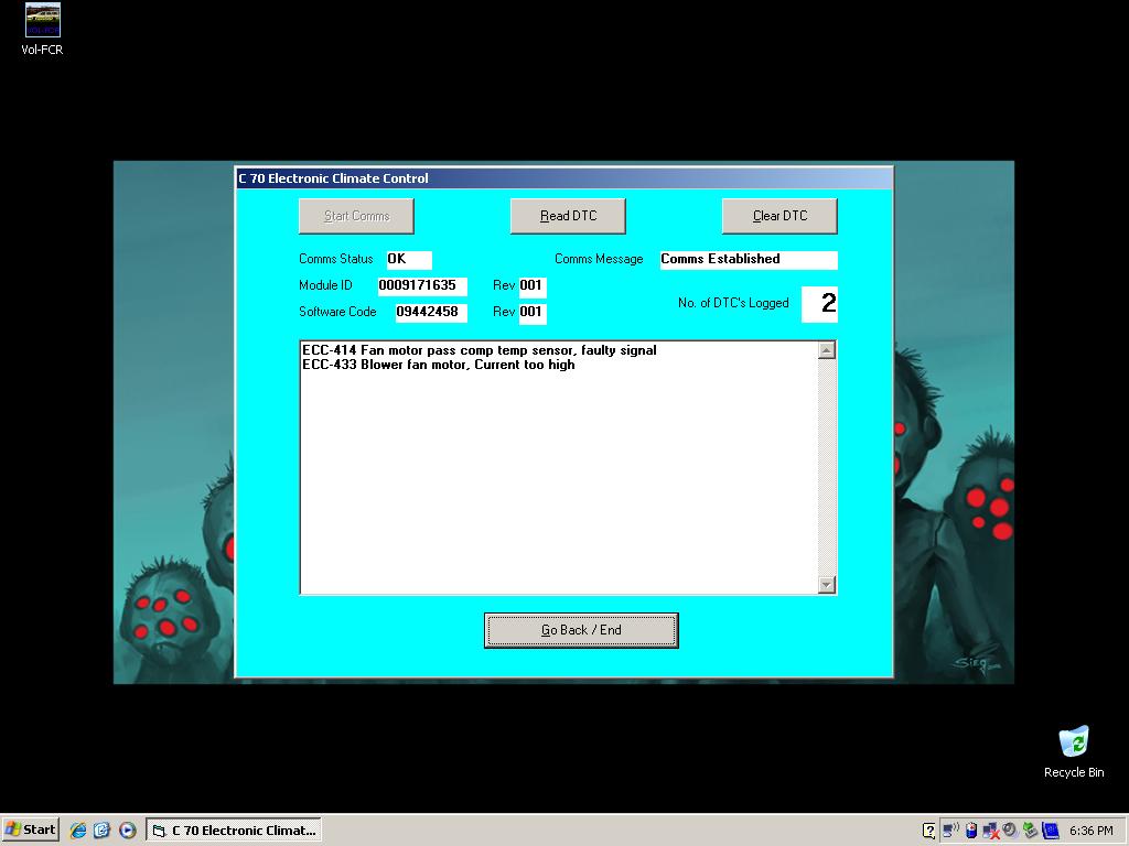

ok so got some Diagnostics action happening.
what do these mean ?

OK the first code means the in cabin temp sensor is bad. There is a little grate next to the switches on the right side of the steering wheel. The fan/sensor is behind there. Sometimes you can blow compressed air in there and it will work for a little while.
The second code usually means the blower motor and resistor is bad.
