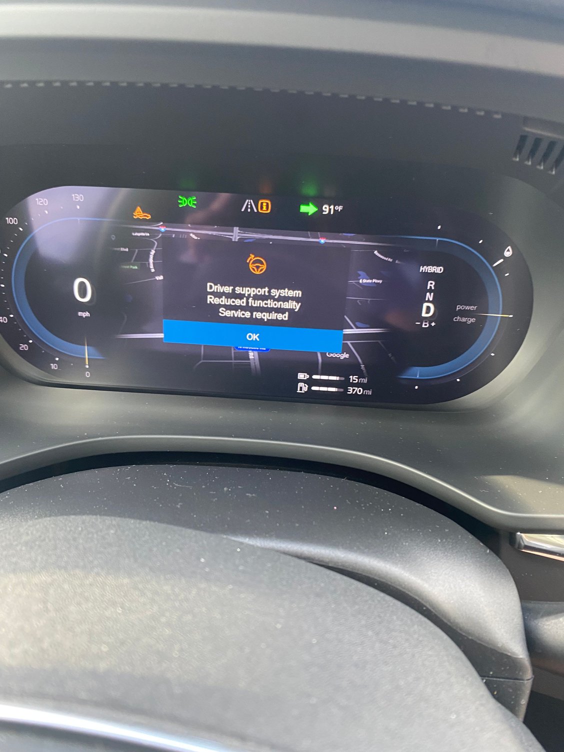

Default Apple car play -update broke steering wheel buttons
Originally Posted by Samzera
I can see on the UK website that the V2.2 was released on 06/20, with Apple CarPlay and more.
https://www.volvocars.com/uk/support...hybrid/2021w46
Is this also available in the US? If yes, when should we see it for download?
Thanks
Any one else have this problem? Why is Apple car play not wireless? Does anyone know why? And my windshield projector doesn’t work. None of the volume buttons, channel Change.. none of it works.. and I can’t even hit ok to clear this message. I am so frustrated!
