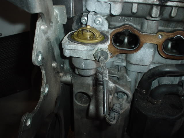

no i have not and i just found out where the sensor was to lol.... can some one type some directions to do it myself
all i know is that i unscrew the 2 bolts from the housing and take out my termostat

Then the sensor is just below on the right side after you have the lid off. You use a 19MM wrench you remove it. The wire below coming out of by the thermostat is the sensor. It will be a little harder on your car because this engine has the intake off aleady.
