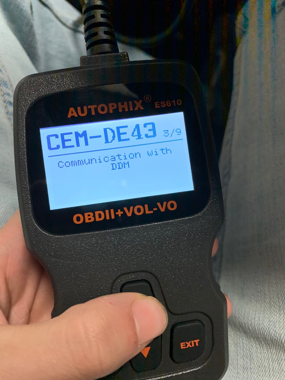

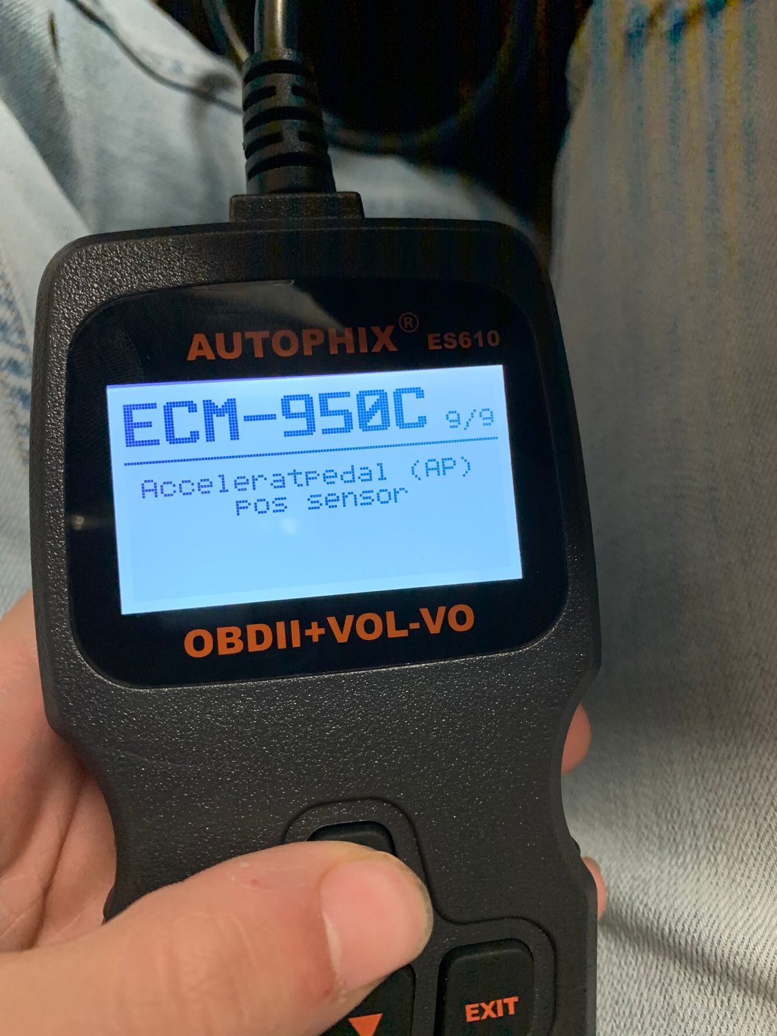

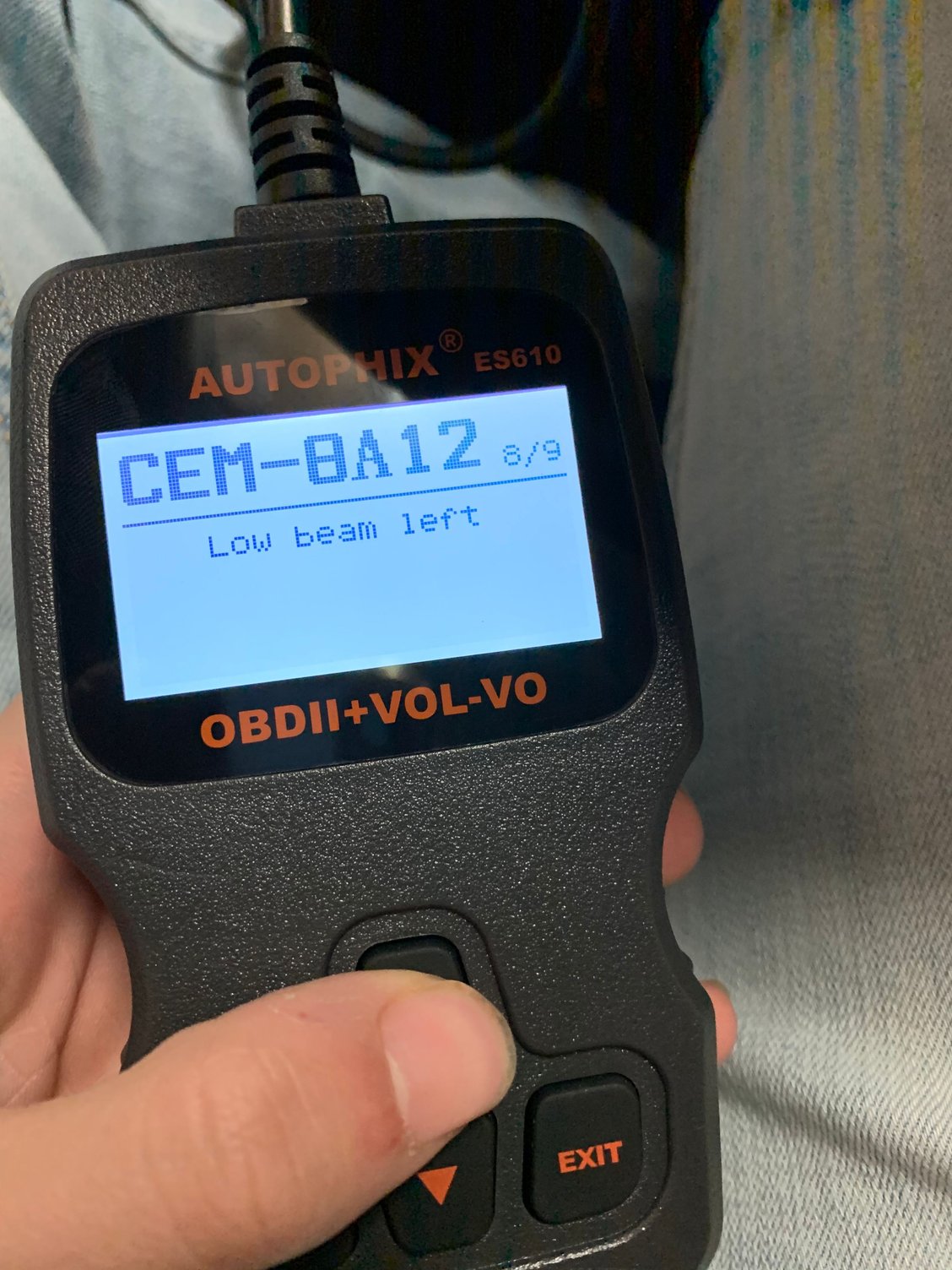

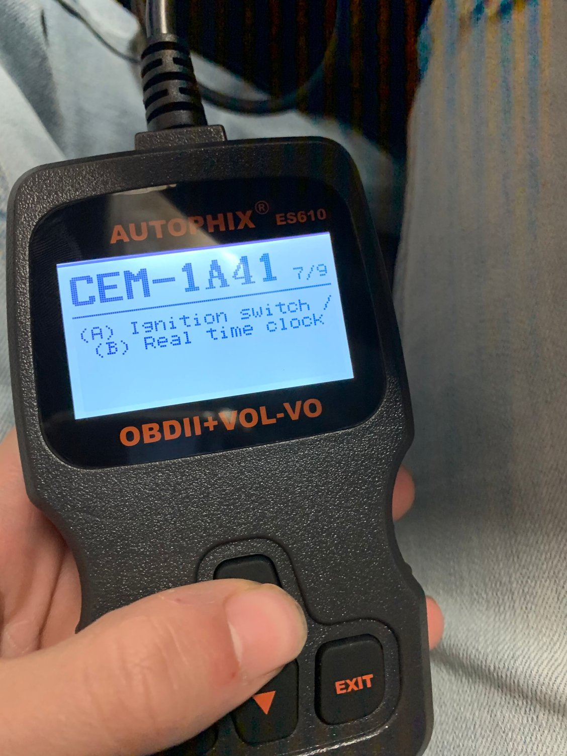

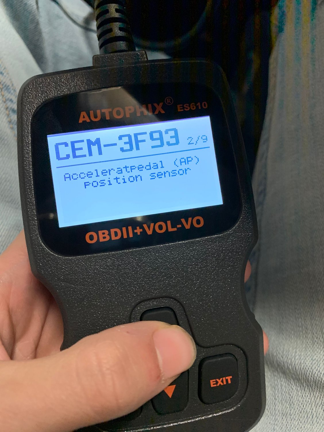

I bought a Volvo scanner and its registering the following codes:
CEM-1a41
CEM-3f93
DDM-e001
CEM-de43
ECM-950c
any ideas would be appreciated!

When you have a lot of seemingly unconnected problems popping up at the same time, it's usually an electrical thing. In this case, I'd make sure that the battery isn't low (as in a bad alternator). Next, I'd suspect either a bad ground, or possibly a bad module (maybe something got wet?).
I'd also have some reservations about the mechanic you're using - the odds of all those spark coils failing are pretty similar to being struck by lightning and a meteor simultaneously. It's always possible that he (assuming it's a guy) is the cause of the additional problems (not every tech knows / understands Volvos).
