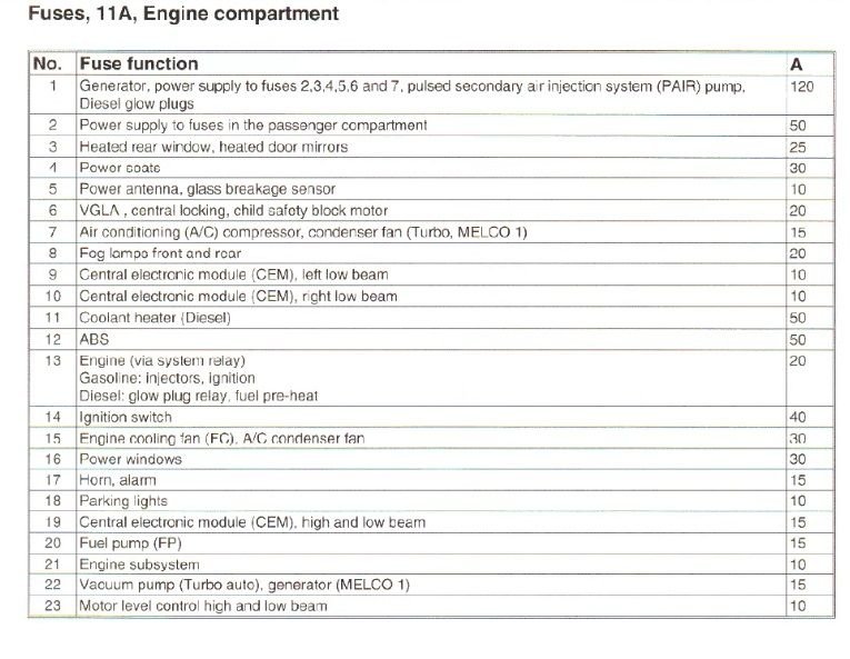

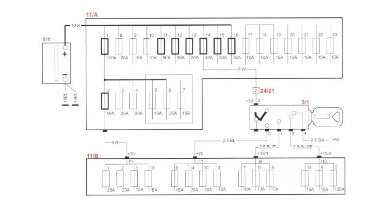

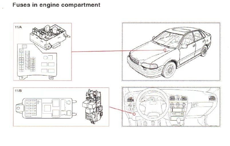

Fuses? With your $5 test light

I started checking the main fuses, but found no issues. That was why I was wondering if it may be a connection somewhere. I mean nothing else works, so I am guessing nothing is making it to the fuse boxes?

Check for power at each of the fuseboxes. If you find one (or more) without, just trace back toward the battery and find the point where your voltmeter reading goes from 0 to battery voltage (the problem lies in between those two spots).
And yes, a bad ground has the same effect as a bad positive cable, so you might start by reading resistance from the negative battery terminal to the chassis and engine block. Alternatively, you can check for any voltage difference (hook the voltmeter up between the battery negative terminal and the chassis / engine block - you shouldn't read more than a small fraction of a volt since they're supposed to be electrically tied together with ground straps).

I checked power going to the fuse box under the hood and I have power going to it. I checked the next one in sequence.
Finally found the issue. The battery was grounding to the chasse, but apparently there are 2 ground wires going from the battery. Found the broken wire and fixed it. Thanks for the tips folks!
