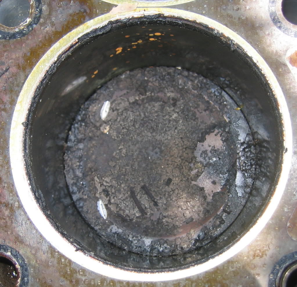

Old Jan 19, 2013 | 06:08 AM
Hudini's Avatar
Joined: Oct 2007
Posts: 2,839
Likes: 17
From: Shanghai, China
Mine were still good. Just had to do a little cleaning up with a very small grinder. Seems like 2 very small relief cuts would have made this engine into a non-interference type. The valves left the 2 oval shiny marks on the left top and left bottom.
