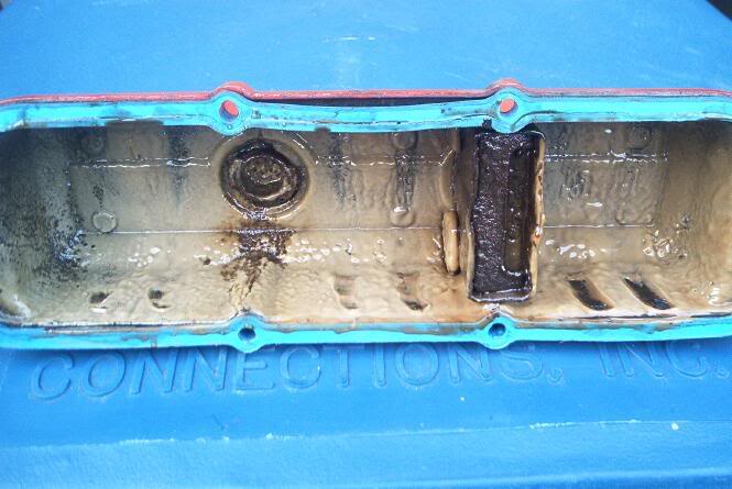

Ok, any water in the oil? It will look like chocolate milk.
White smoke out the exhaust is coolant being burned. The tell tale sign is a very bright white spark plug because it's literally being steam cleaned.
You say the head is reman? Has it been checked to see if it's warped? A warped head can allow coolant into a cylinder or crankcase when the head gasket won't seal.
