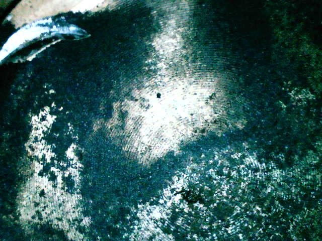

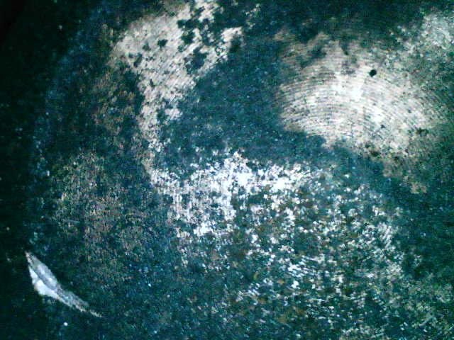

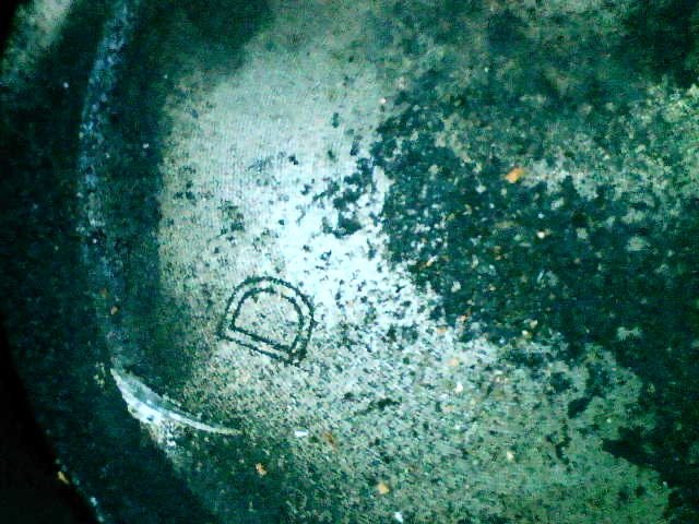

Thread from the dead. This just happened to me. 2013 S60 T5 2WD 109K miles. Im upside down in this car and hurting for money due to corona virus. I depended on this car f*** me. I havent bothered putting on a new belt. Instead I just borescoped the cylinders to see the shiny new marks on my pistons. I've got shots of all cylinders accept no.4 because it was pretty much top dead center and it was too high for my camera.

a nice set of valve dings. is the timing belt intact? if this was a recent event (running nice them boom...) you likely have bent exhaust valves. If the belt is intact you may have jumped timing - check the timing marks, then do a compression test. a turbo engine should be 150 PSI, NAs about 180.

yup. Driving roughly 35mph. Slowly accelerating from a stop light in traffic and power went gone. Timing belt is intact. Im not going to bother with a compression test. Motor totally had a bad day. Good news is no broken valves on the pistons I guess?

Yep, that stinks. FWIW, that mileage / age seems awfully "young" for a timing belt to slip like that. Maybe something else failred (tensioner?) or it got oil-soaked at some point?
The good news is that you don't have to spend more time troubleshooting the engine - it's a paperweight. I guess it might be possible to do a head swap but I'm betting you will spend less time and money just finding a good boneyard motor and swapping out the whole enchilada.
