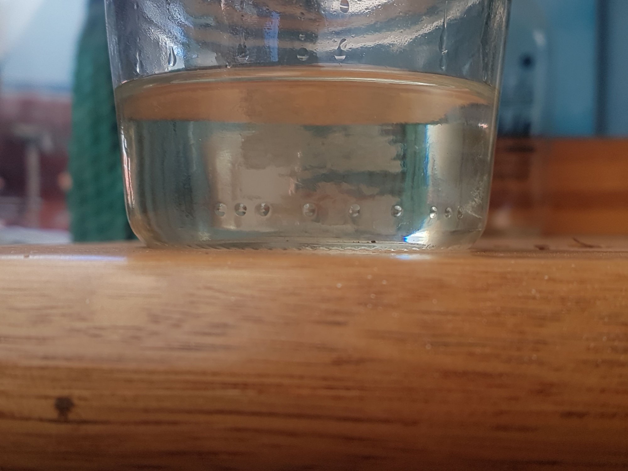

Old Jun 28, 2020 | 01:38 AM
jacobrice's Avatar
Joined: Jun 2020
Posts: 7
Damn It!!!
Got down there this morning. Sweet mother of god it was cold.
Anyway, "cracked" the hose at the back of the fuel filter and drained into a jar.
This is the result. Didn't appear to be any water in the system which is a good sign.
New symptom though. The fuel gauge (digital) started bouncing around like it's on a jumping castle. My guess is the relay cracked it. It only bounces between it's highest level and full. If that makes sense.
BTW: Really want to thank you guys for all your help. Really appreciate it.
All fuel. No H2O.
Old Jun 28, 2020 | 02:53 AM
GerBeGurGya's Avatar
Joined: Oct 2009
Posts: 359
Likes: 7
From: Las Vegas NV
Good to see no water.Now you just need to replace the fuel level sender unit.Now that you mentioned that your gauge is jumping that would explain why you ran out of fuel.
