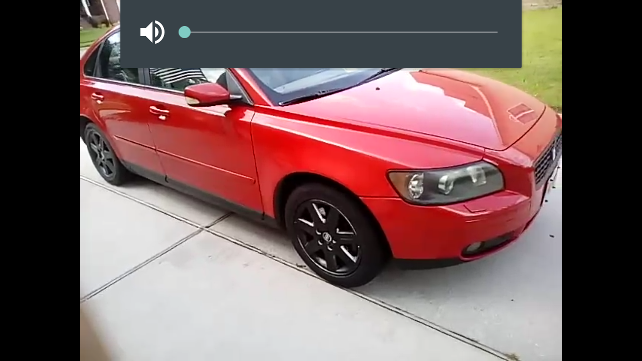

Now that the mechanical issues have been addressed I worked on a cosmetic issue that had been bothering me for some time - rotted black rubber window trim!
I used black Plasti Dip and I am very happy with the results. I had extra so did the emblems as well. Bought more and did the grill. bumpers, rocker panels, exhaust tips, wheels and pinstriping My daughter asked why I stopped as sh is fine with a Black car but my wife felt otherwise
