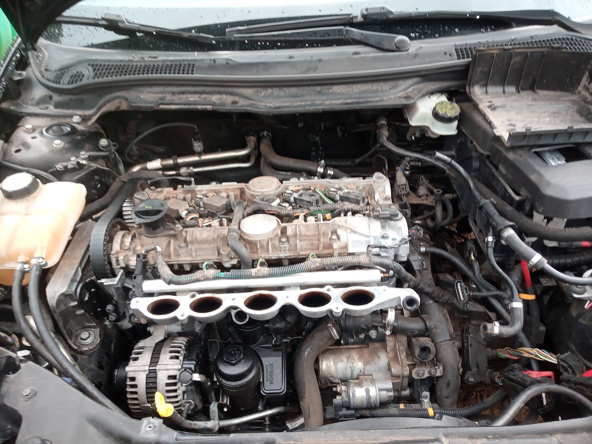

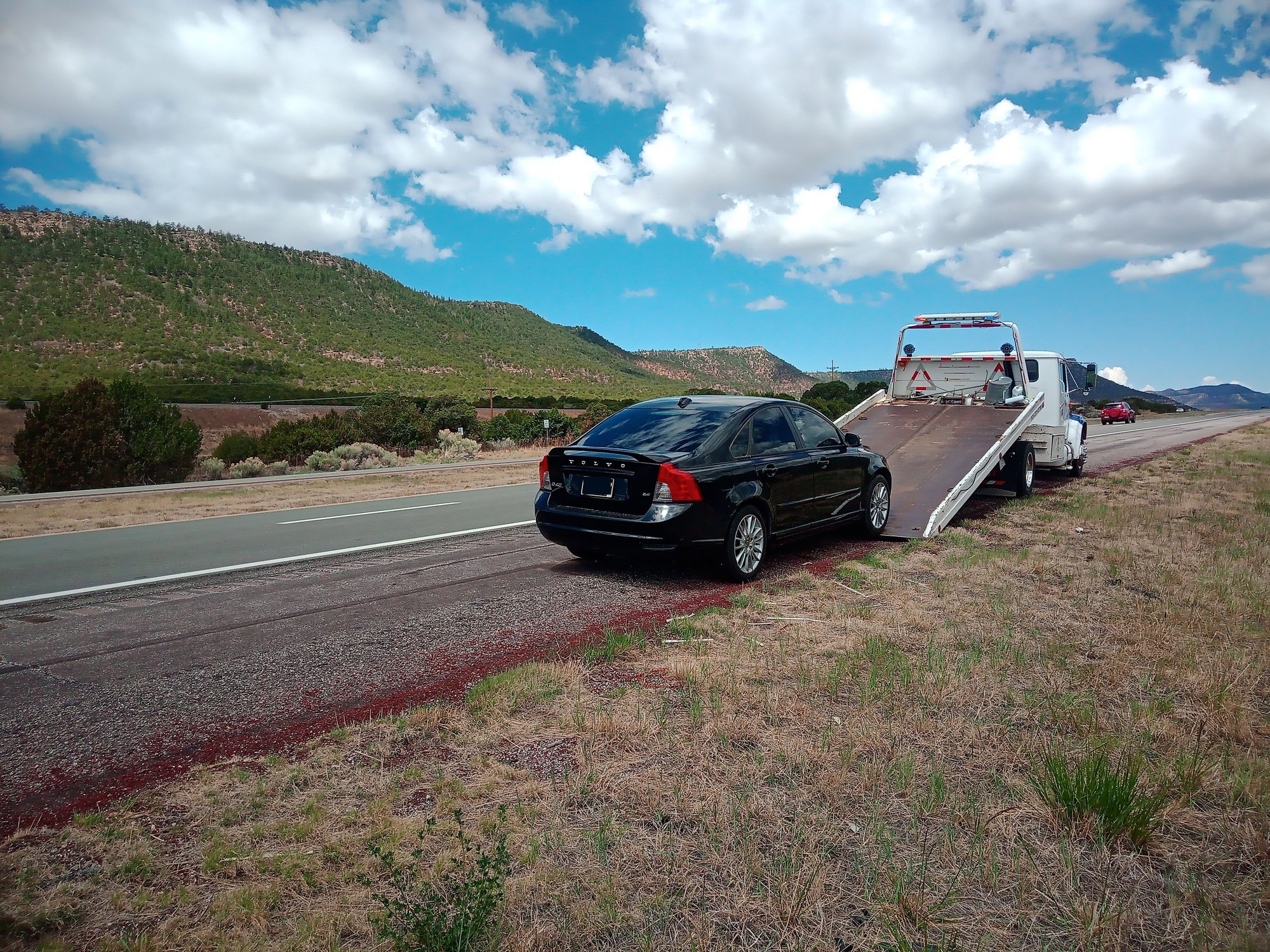

I found a nice 5spd 2010 Volvo S40 2.4i on Craigslist that i bought for my wife. On the first trip after buying it the car starts losing power and blue smoke comes up from the hood. Oil light comes on and I pull over and turn off the ignition. Oil is everywhere all over an engine I just inspected that had no leaks.

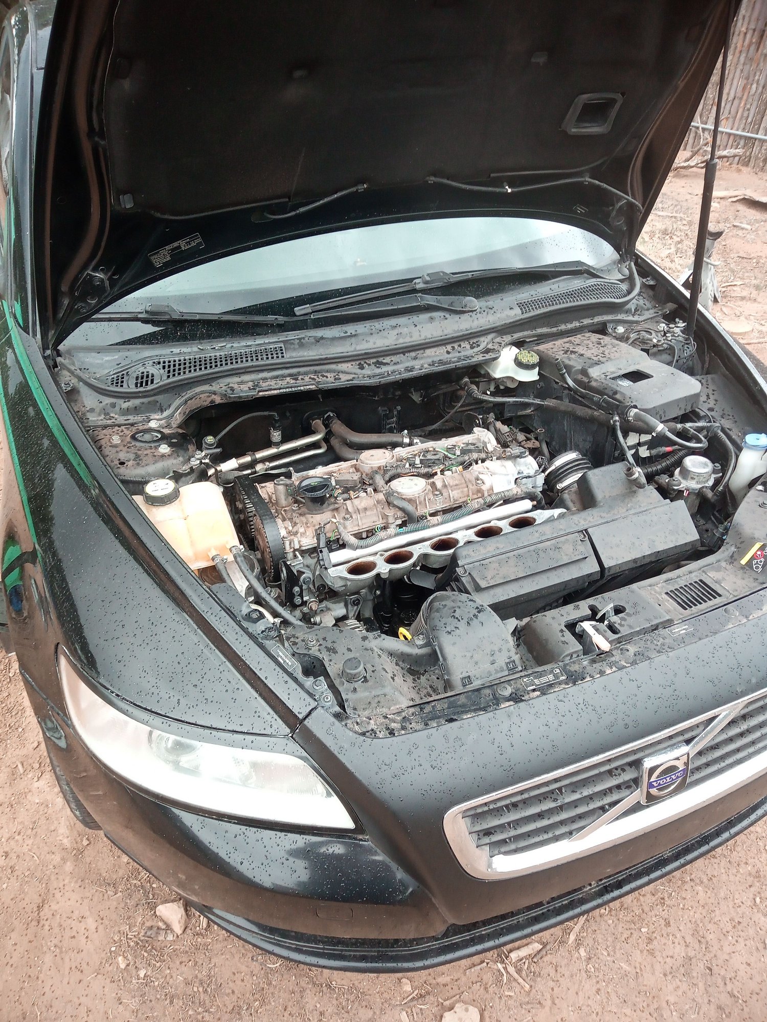

The car never starts again after filling up. I pull the timing belt covers, I find oil coming from the bottom front of the engine. Doesn't look like camshaft seals, pull harmonic balancer and it looks like crankshaft seal or oil pump. No build up of sludge on the engine. Very strange.
Compression test the engine and I am cussing and kicking. Most of the cylinders are under 60 PSI >:0
Start researching replacements for a 2010 Volvo with a B5244s engine as printed on the head.

These engines generally do not "blow piston rings", They can get damaged from being severely overheated, which can easily happen since there is no low coolant warning system - but you don't mention overheating. I would suspect a cam timing issue causing your lack of compression. How much oil did you need to put in?

It shouldn't be hard to check the timing (since the timing belt cover is already off). I do think the slipped timing belt sounds like a likely cause of the problem, with the oil leak coming as a result of some of the carnage inside the engine (seriously whacked valve stem seals).

3 quarts low is not enough for oil starvation or the oil light to come on - so the bottom end is probably ok. Your pictures don't show quarts of oil under the car - unless it's further back. An engine with bent valves spins over much faster than an engine with compression - and covers are off so it should just take a few minutes to confirm whether the cams are out of time or not. If they are yours is an inference engine and 99% of the time if the cam timing is off the valves get bent. R&R the head is a complicated job but many DIYers have successfully gotten it done - and yours is easier - there's no turbo to deal with!
In my humble opinion a cylinder head job is a lot easier and cheaper than a replacement engine. Sorry for your troubles.

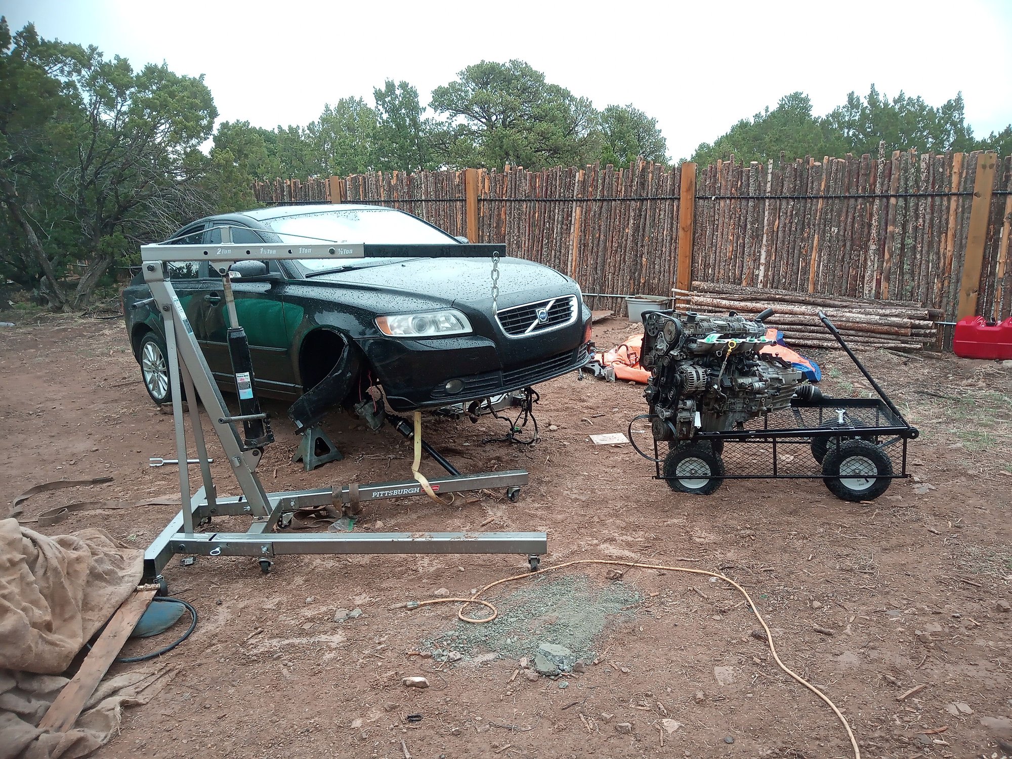

Update. I removed the engine. Shame the garage is not finished yet. It was a pain with this weather.
I'm going to strip down the engine and take it to a local machine shop so they can tell me what I am looking at. I need to know what happened!
Still can't see where exactly it spewed oil from. The subframe is covered in oil.
Need to take plastic off the front of the engine. Oil Pump and camshaft seals are fine. Something above crankshaft seal spewed oil.
Timelapsed the removal from a security camera:
