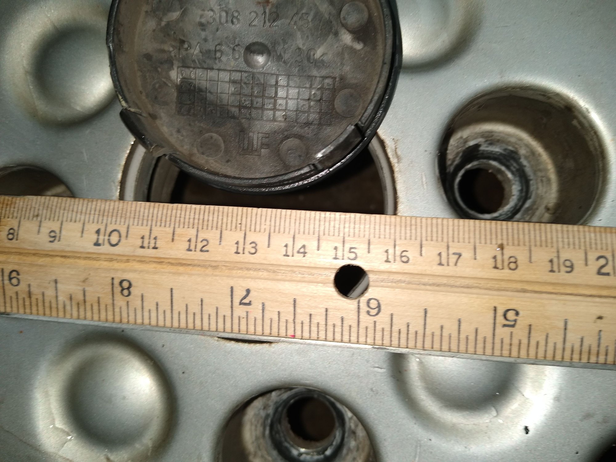

Can someone please tell me what size Center Wheel Caps does a 2000 Volvo S40 2.0 take? Internet says 60mm, I've measured and it's 57mm, yet some say it's 64mm.

I have 15 inch tyres. I don't know the dimensions of the rim. They are the factory rims. This is a picture of the rims.

Why not just measure the hole (corresponding with the diagram Dingus1 provided)? Seems a whole lot easier than trying to track down info on long-discontinued factory rims.

Hi buddy, I have measured and also got two other people to confirm what my measurements were & we all agree on 57mm. The diagram provided is 55mm and 60mm, which is also what the internet says, together with 64mm.
I was hoping someone owns a 2000 Volvo S40 which has center caps and would be able to assist after measuring theirs.
Here in South Africa, it is 400zar which is roughly 28 dollars for the set of 4, which is why I want to make sure I get the right size.

To add to that, do I go with 55mm or 60mm when ordering? Since the inner diameter is smaller than than the outer? 55mm is the closest to 57mm as supposed to 60mm.

Volvo only shows 1 center cap for the Gen 1 S40s: PN# 30638643 PS your wheels are called "Spectra" $10.85 at Tasca Parts (a dealer web store)
https://www.tascaparts.com/oem-parts...r-cap-30638643
I'll be doing a snow tire change on my 2000 s40 over this weekend and can snap a pic. I run 15" Spectras for the snows and Gallatica 16" for the summer - the cap fits both.

The 55mm and 60mm are measuring 2 different parts of the same cap. So like mt6127 mentioned and linked the same part i did, but cheaper, i would go with those which are 60mm. If you measured where the cap goes and got 57mm. sounds like they left 1mm clearance on either side.

I wonder if he's measuring the inside diameter of the "big hole" (outside) or the "little hole" (inside) at 57mm.

Measured inside the big hole Sir.

To note, the OEM part number here is 30821245. That should be all you need to know. I don't own a micrometer/ inside caliper to extactly if the OD is 59 or 60mm but its very close.
