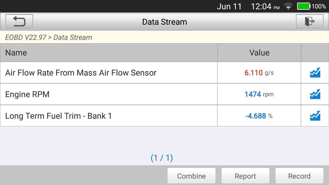

My long term fuel trim is almost -20% at idle. At higher rev it comes much closer to 0%. Scan of engine temp is correct. Air filter is clean. I did some scans of the MAF. Here are some snap shots at 3000, 1400 and 700 rpm. Is my MAF correct at these rpms? Why is my long term trim so far negative at idle?

This may not be the site that gets into this level of technical issues but I'll share my solution for the fuel trim problem I have. The brake booster is fed through an octopus assembly of vacuum lines. One line is attached to the plenum (downstream from the MAF). It is a controlled venturi "leak" and provides a continuous known air leak that is designed into the MAF map. At idle this controlled air "leak" is needed. My vacuum line was clogged, no vacuum felt at the air box end of the vacuum octopus so the ECU was compensating for this lack of air by leaning out my trim (large negative value) at idle. At higher rpm regimes the trim levels approach 0 because the air "leak" is a smaller percentage of the air coming in downstream from the MAF. I'm picking up a new hose, PN 31201430. Pretty certain this will fix my negative long term trim. Maybe this will help someone else out there. Especially if they get a OBDII code P0172, system too rich. That code along with LT trims that :fix" at higher RPMs can be due to a clogged brake booster vacuum line. Other cause of too rich could be a dirty/clogged air filter but LT trim will not improve at higher rpms in that case.
